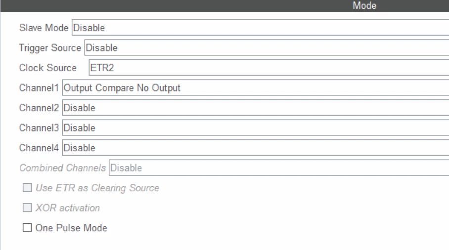

STM32CubeMX sets Timer 2 CC1E bit in the CCER register even when I select "Channel 1 Output Compare No Output"
  • June 12, 2023
  • 3 replies
  • 2287 views

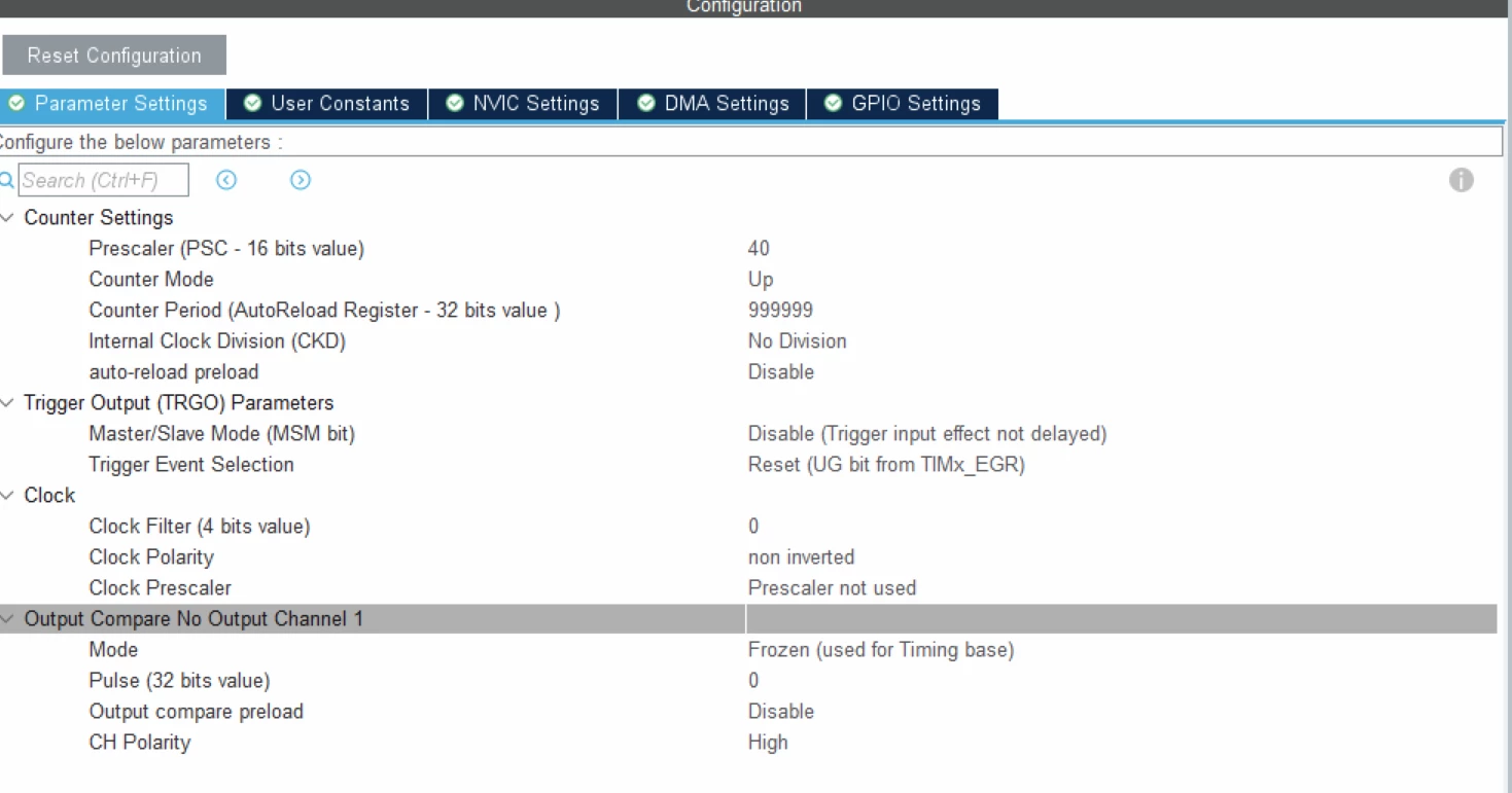

For Output Compare No Output Channel 1 I select "Frozen (Used for timing base)".
I discovered this when trying to use the TIM2_ETR pin as a source for the clock. The input clock is killed when the HAL libraries set CC1E.
Is this a bug in the cube or am I just getting the setting wrong?

I should have made it more clear, I have solved the problem.
The cube generates the correct code, but I added the line HAL_TIM_OC_Start_IT(&htim2, TIM_CHANNEL_1); into main() manually to enable the Output Compare interrupt.  I did not realise that this line also enables the output.
