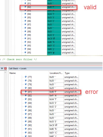

Sergey GretchanyAssociateForum|Forum|7 years agoMay 21, 2019Questionstm32cubemx+sdio+fatfs skipped byte and error FR_NO_FILESYSTEMForum|Forum|7 years agoMay 21, 20190 replies605 viewsHello freinds, I have problem with sdio and fatfs, on some sd cards value label FAT32 begining at 81 byte, valid start position 82. And offset end sector at 507 byte, in valid card in 510.Board stm32F4discovery, version stm32cubemx 5.2.0, FW_F4_V1.24.1Thank.STM32CubeMXFatFSSDIO-SDMMCSTM32F4 series
