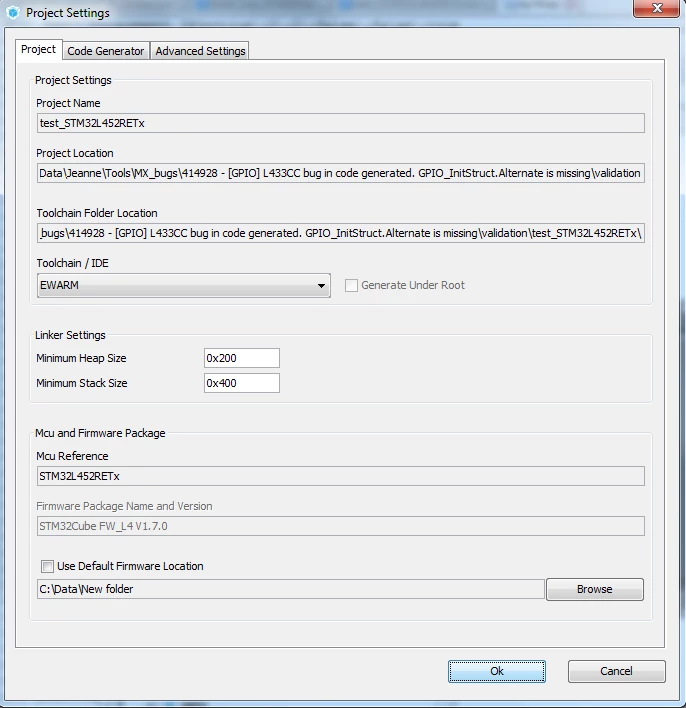

The absolute path of a CubeMX project is embedded in the .ioc file. This makes a little more difficult moving the project elsewhere or restarting with the project for example when retrieving it from a remote Git repository.
It would be better having the option to keep the project location-agnostic and to regenerate the project-derived files in the directory which contains the .ioc file.

Mar 30, 2017 12:55 AM UTC
Posted on March 30, 2017 at 00:55
This just isn't true. My .ioc project files, including a new one just created with 4.20, record an absolute path for the Cube repository directory:
ProjectManager.CustomerFirmwarePackage=/home/<user>/STM32Cube/Repository/STM32Cube_FW_F4_V1.15.0
I would really really, really love to have the STM32Cube repository be able to be stored in a path relative to the project. That would enable me to keep the Cube FW in a source repository so that it could be centrally managed for all project users.

Hi
Schober.Bryce
You can change the use default firmware location and give a relative path to the project (at the bottom of ProjectSettings/Project as below and untick ''Use Default Firmware Location) :
In you ioc, you will have the path you want.
BR. Eric
