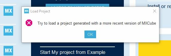

STM32CubeMX reports "Try to load a project generated with a more recent version of MXCube"
As a long time bare metal and STM32 Std Library user, I am trying to brush up my skills to use the HAL interface (and other things). Using STM32CubeMX V6.2.0, from the New Project from Example form, I double clicked on the example UART_ReceptionToIdle_CircularDMA and it downloaded a project. When I try to open the example it just gives the message "Try to load a project generated with a more recent version of MXCube". This happens with some other USART examples, for example UART_Console.

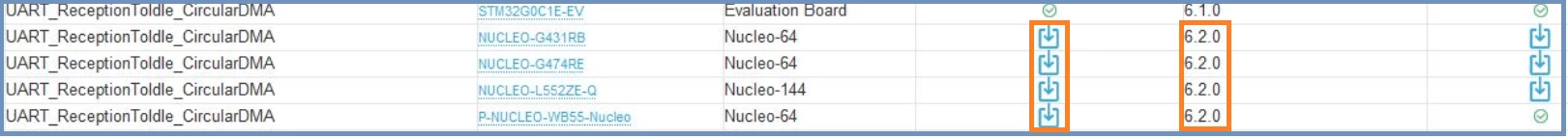

According to the image shared, the 6.2.0 CubeMX version is not installed in your machine (or maybe an error has happened during the upgrade), and these 4 examples requires the latest CubeMX version and consequently the latest CubeFW version for the G4 and L5 projects, and that's explain the NOT FOUND message error that you have faced :
0693W000008wx1QQAQ.pngPlease follow steps below to solve your problem:
*/Uninstall your current CubeMX version
**/Install the latest CubeMX version from site
***/Open Example Selector ( you will not find the download icon beside the 6.2.0 version this time)
In case when the FW version is not present, it will be automatically installed when you start your project. (If you still face a problem please attache your .log file under C:\Users\login\.stm32cubemx)

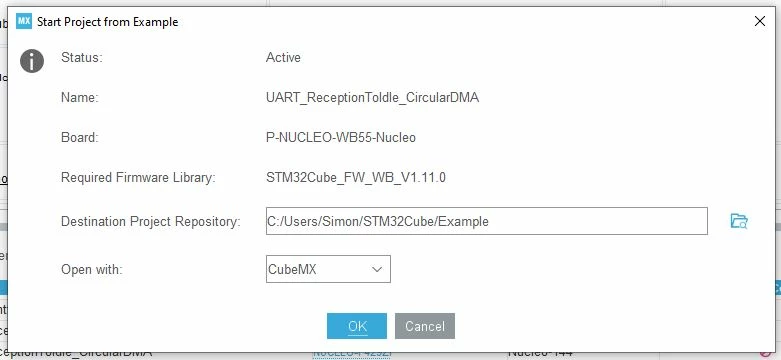

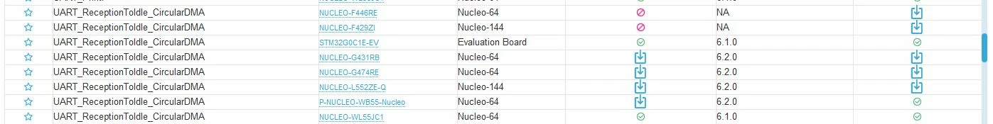

From the main window of STM32CubeMX select "Start Project from Example". From "Example Selector" screen Enter keyword UART/USART. In the list of examples I get these 8 possible CircularDMA examples as shown below.
I am going to select #7 because that saysSTMCUbeMX Version 6.2.0. So that is P-Nucleo-WB55-Nucleo.
Then I get this dialog
Then I click okay and it seems to download some files, then it takes me back to the STM32CubeMX main page and displys this message:
I think I have tried most or all of these CircularDMA examples with either this result, or the other problem I described, which is that from the first dialog above, it seems to download something but the dialog is on the screen such a short time I can't read it, and then it just goes back to the home screen. And this is true of so many of the examples.
Thanks in advance (I am working on Atlantic time) Simon Morrison
