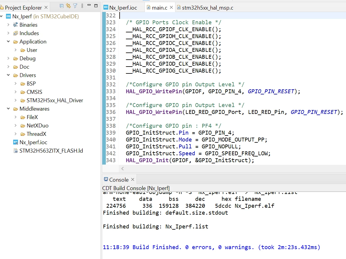

STM32CubeMX: regenerated code of iperf example does not build anymore
I setup a fresh project with STM32CubeIDE 1.12.0 (CubeMX 6.8.0) based on the iperf example for NUCLEO-H563 board. The project build and runs correctly. Fine!
Then I opened the ioc file that comes with the example and did a small modification (add PF4 as GPIO output). Then I regenerated the code.
As a result the project outline changed and the project did not build anymore due to lots of undefined references by the linker (SystemInit(), _tx_timer_interrupt(), many HAL_* functions).

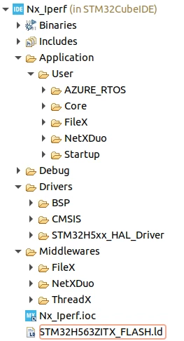

Original project structure:

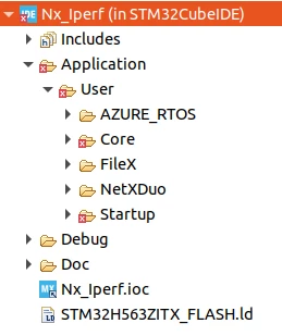

Structure after code has been regenerated:

MFuch.3
MFuch.3Author
Mar 22, 2023 7:04 PM UTC
New structure:
0693W00000aJVxkQAG.pngOriginal project structure:

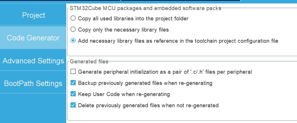

Hello @Community member​ ,
After modification (add PF4 as GPIO output) , go to project manager -> Code generator :
0693W00000aJYyqQAG.pngRe-generate the code:
Hope I helped you!

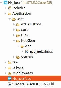

MFuch.3Author
Mar 23, 2023 9:47 PM UTC
Thank for testing. I retried with exactly same setting from code generator.
But finally Application/User/NetXDua/App/nx_iperf.c vanishes during code generation and the build process still fails.
I am running on ubuntu 20.04 host.
On disk the complete folder Middlewares/ST/netxduo/utility/) is missing after regeneration - may be more.
Foued_KH
Mar 24, 2023 11:04 AM UTC
Could you try please to enable the " Backup previously generated files when re-generating "
Foued
MFuch.3
MFuch.3Author
Mar 24, 2023 3:47 PM UTC
This option was already switched on.
