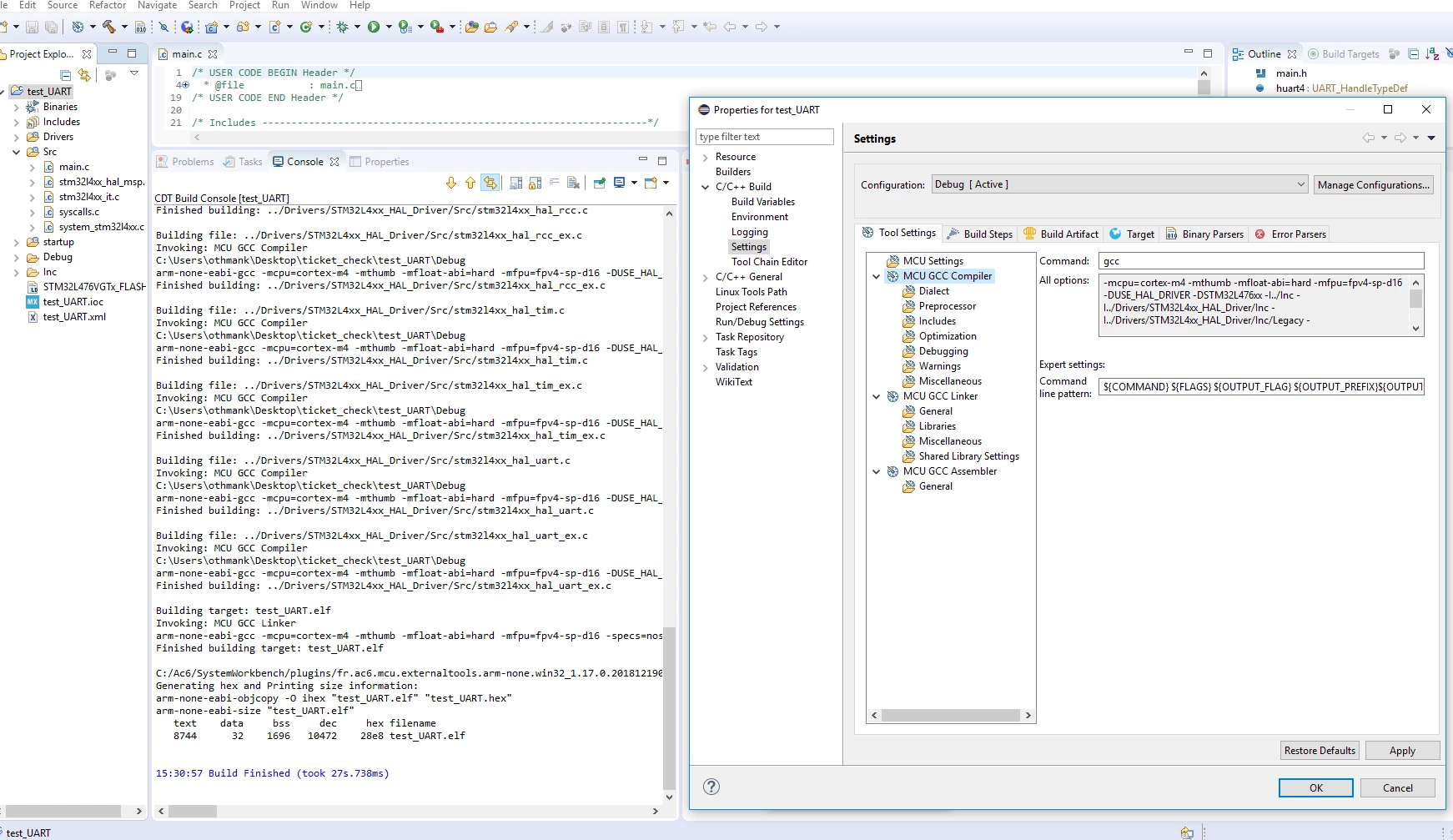

These are the errors seen in ac6 ..
Error: selected processor does not support `dsb 0xF' in Thumb mode
Drivers/STM32L4xx_HAL_Driver/Src/subdir.mk:72: recipe for target 'Drivers/STM32L4xx_HAL_Driver/Src/stm32l4xx_hal_cortex.o' failed
C:\Users\RAVI\AppData\Local\Temp\ccicODeQ.s:286: Error: selected processor does not support `isb 0xF' in Thumb mode
C:\Users\RAVI\AppData\Local\Temp\ccicODeQ.s:330: Error: selected processor does not support `dsb 0xF' in Thumb mode
C:\Users\RAVI\AppData\Local\Temp\ccicODeQ.s:351: Error: selected processor does not support `dsb 0xF' in Thumb mode
C:\Users\RAVI\AppData\Local\Temp\ccicODeQ.s:935: Error: selected processor does not support `dsb 0xF' in Thumb mode
C:\Users\RAVI\AppData\Local\Temp\ccicODeQ.s:946: Error: selected processor does not support `isb 0xF' in Thumb mode
C:\Users\RAVI\AppData\Local\Temp\ccicODeQ.s:983: Error: selected processor does not support `dmb 0xF' in Thumb mode
also wanted to know why in ac6 directly when I open after generating the code from STMcube..not able to see STM MCU part number under MCU settings..any pointers to error there.let us know
--Ravi

when you say log file are you referring to the build conf??..as follows

I know we need -mcpu -cortex -m4 ..you are able to get in your MCU gcc compiler option...also but why I am not able to get the same..anything related to Java..initially I had some java error ...kindly let me know why this is not refelcting in my build environment??
I think if I get this through I can also buld the same

Khouloud OTHMAN
July 3, 2020
Hello RShiv.1,
You'll find the STM32CubeMX.log file under <user>/.stm32cubemx folder. Otherwise if the linker file STM32L476VGTx_FLASH.ld isn't generated once you generate code through CubeMX, then your issue may be related to the JAVA version. Please check the version installed on your machine. JAVA 13 is not supported by STM32CubeMX, the max supported version is actually JAVA 11.
More information on installation requirements and procedure is in the STM32CubeMX for STM32 configuration and initialization C code generation user manual (UM1718).
BR,
Khouloud.

Khouloud OTHMAN
July 6, 2020
Hi RShiv.1,
Backing to .log file you have shared you are using java 14 which not supported by CubeMX.
Please uninstall this version and correctly install a Java version supported by STM32CubeMX ( max java 11). This will surely solve your issue.
The use of Java Run Time Environment 1.8_45 64-bit is strongly advised to prevent the unavailability of some features such as code generation for the STM32CubeIDE toolchain.
BR,
Khouloud
