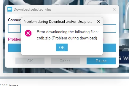

    Moreover, whenever I try to create new project, use board selector or part selector STM32CubeMX tries and fails to download a file:
    … after that it seems to be OK …
    This happens every time, the ‘helpful’ suggestion is to ‘try it later’ ...
