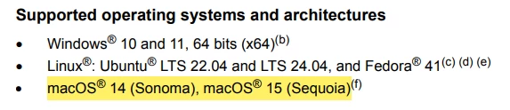

For macOS the full disk access is required to load project files or install other packages from the file system. To enable full disk access for STM32CubeMX:
1. Go to “System preferences” and click to open “Security & Privacy” window
2. Select “Privacy” tab
3. Select “Full Disk Access” from the left panel
4. Click the checkbox to enable full disk access to STM32CubeMX
--> Hence, all folders will be visible.
This is detailed in the user manual of MX, particularly in section "3.1.1. Supported operating systems and architectures" (see attached screenshot from MX UM)...

Tahoe isn't listed as a supported OS. Might have to wait.
With the shift to VS Code, it's not clear how long it will take to support newer OS versions.

As mentioned by @TDK Mac Tahoe 26.1 is not listed as a supported operating system for STM32CubeMX 6.15.0. This means that the application has  not been tested or optimized for compatibility with this version of macOS. As a result, certain features such as file system access may not function as expected.
