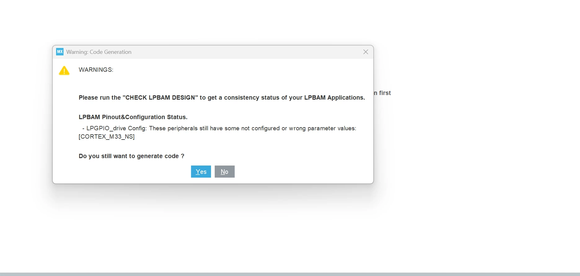

Hello @ElectronicABC
This is not blocking: it’s just a warning, not an error, so you can press “Yes” and the code will still be generated.
The warning simply indicates that there may be a logical/configuration issue in the LPBAM setup, even though valid C code is produced.
If the example runs correctly on your board, you can safely ignore the warning.
If the behavior is not as expected, use this warning as a clue to review the LPTIM and LPGPIO settings in the LPGPIO_drive LPBAM application.
THX
Ghofrane

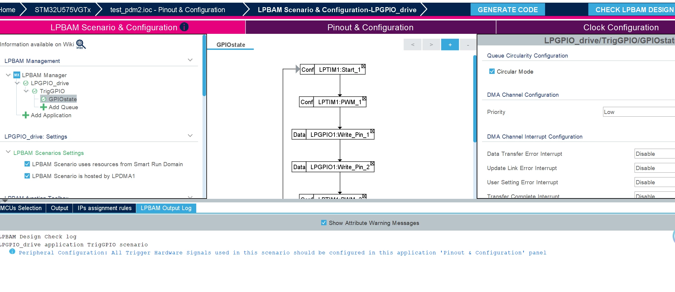

January 25, 2026
January 25, 2026
click check ,only show this
