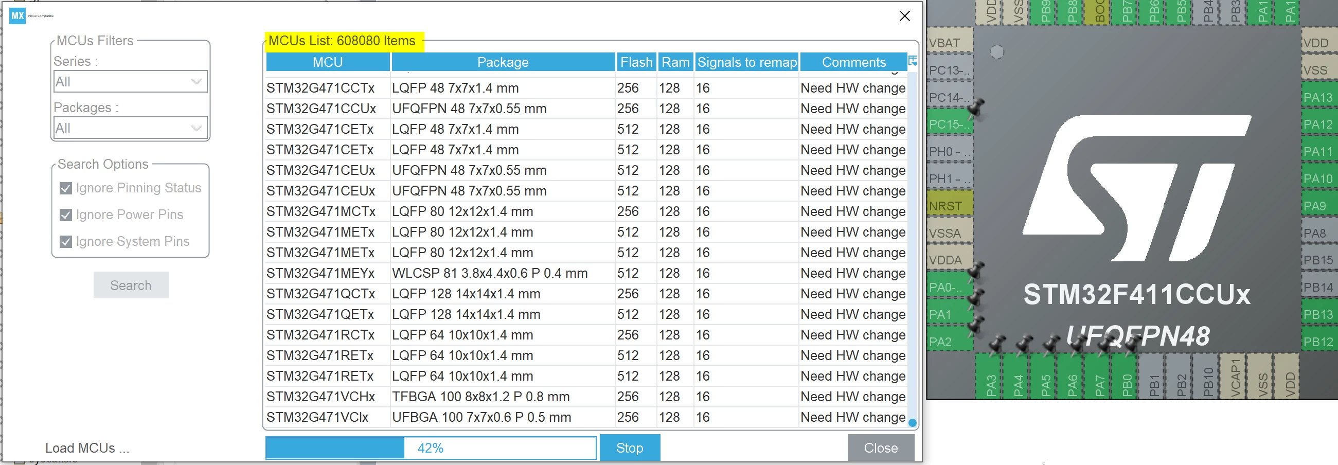

0693W00000NskL5QAJ.jpgAfter a month it is still not fixed.
The processors are extremely difficult to obtain and then this feature fails. The tool finds just over half a million chips in one day. I'm seriously wondering if ST is actually interested in the whole thing.
