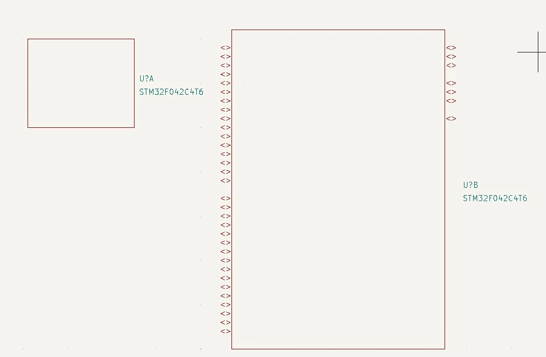

I used the TOOL -> CAD Tab.
Choosing Kicad as CAD Product. Export Pins including labels. Then download CAD Model.
The model is generated but includes no connectable pins as shown in the following graphic.
0693W00000QLx5aQAD.jpgI also checked the generated files. It only contains the information for the shape.

The CAD Subtab was added with STM32CUBEMX 6.6 and can be found right below the PCC power tools in the tools tab.
Steps to reproduce:
  1. Select any MCU
  2. Configure Pins in any way shape or form
  3. Select the Tools Tab next to the Project manager Tab.
  4. Select The CAD Sub-Tab right below the PCC subtab.
  5. Select KiCad from the DropDown Menu
  6. Klick the Checkbox below the Drop Down menu. Kicad should now be displayed in the table in the top center.
  7. Agree to Terms and Conditions
  8. Press the CAD Download Button
  9. Save file wherever necessary
I am sorry for not providing the necessary steps in the first place.
