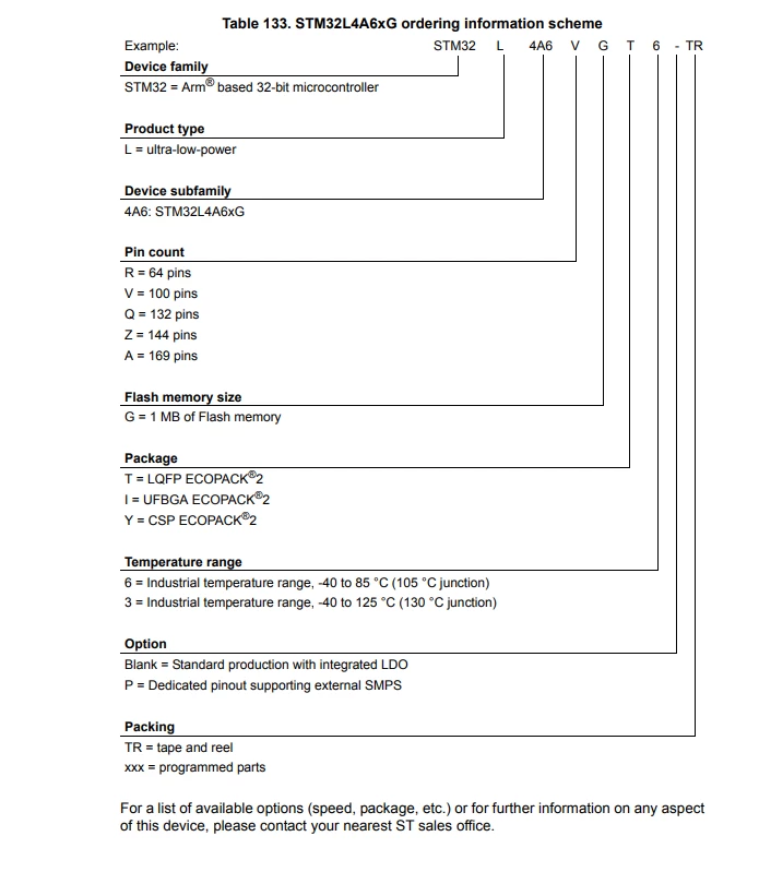

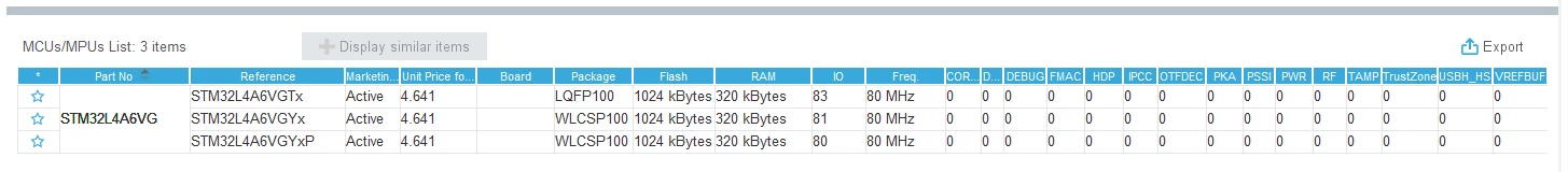

I think i know how to search ;)
Linas L
Linas LAuthor
Senior
Mar 29, 2020 7:55 AM UTC
no lqfp100 package
Nesrine.JLASSI
Visitor II
Mar 30, 2020 10:38 AM UTC
Hi @Linas L​
I checked again and confirm that STM32L4A6VGT6P is missing in STM32CubeMX. This is reported internally.
