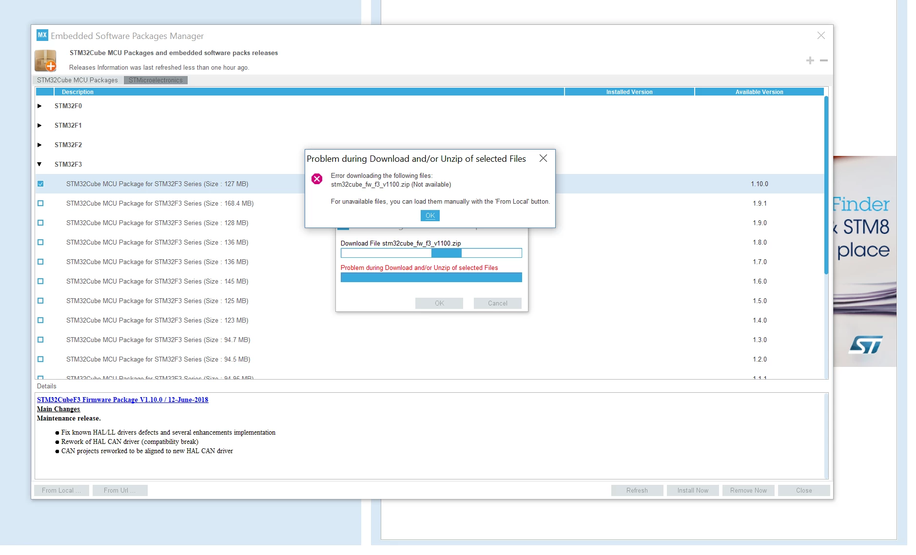

STM32CubeMX irresponsive after firmware download failure.
Tested with STM32CubeMX 5.1.0, 5.0.1, 4.27.0: I open the Embedded Software Packages Manager and click on a new firmware to install, press Install Now. The Download fails for unknown reason (network overload?), thats okay. See attached picture. But, when I close the Error Message Box, the Progress Message Box stays open with all buttons deactivated. There is no way out, I have to kill STM32CubeMX using the task manager :(

Hi @KnarfB​
I did the same scenario and did not get any error message. I think it's a network problem not CubeMX.
