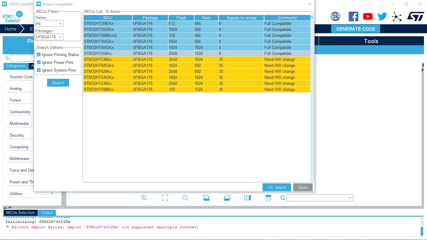

Greetings,
I'm having trouble porting the existing CubeMX configuration to a pinout compatible MCU.
I'm using STM32H745IIK6 and trying to change it to STM32H755IIK6 following the instructions on page 287. of UM1718 Rev 34 ("Tutorial 5: Exporting current project configuration to a compatible MCU"). But, when I select the MCU and click "OK, Import", I get the following error:
0693W00000BajB5QAJ.pngThe existing CubeMX configuration loads fine and I can modify and save things, but when I try to do this MCU change, that error occurs.
Is there any fix to this, since it would be pretty annoying to have to manually copy everyting from the existing CubeMX configuration?
I'm using version 6.2.1.
BR,
Domagoj

Hello @Domagoj Tomić​ ,
You're right, I can reproduce the issue and it will be fixed.
Thanks for raising the problem to our attention.
Khouloud

Jun 14, 2021 7:39 AM UTC
Thank you for your post,
Could you please share your ioc file to check your case?
Khouloud

Unfortunately I cannot send you that specific .ioc file due to our NDA policy, but this is a second .ioc file.
It's a default configuration with two GPIO pins set as output.
It behaves the same, i.e. shows that error when I try to change the MCU to STM32H755IIKx.
Khouloud
