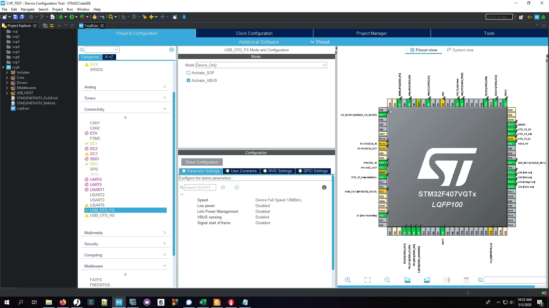

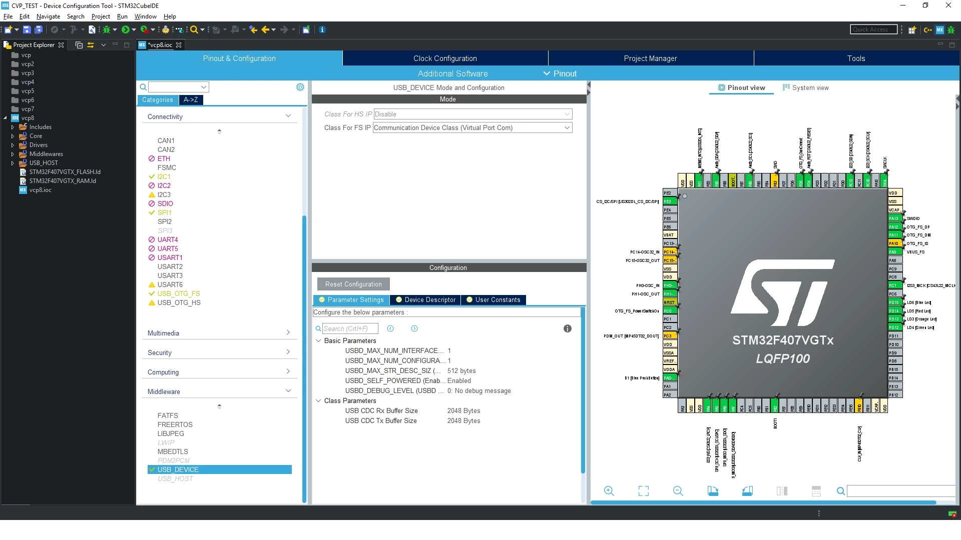

Ive started a brand new project, used the CubeIDE board selector to select the Discovery board (STM32f407). I've Configured USB_OTG_FS to 'Device_Only' mode, SOF off, VBUS on. I have changed the USB_DEVICE "middlewares?" to, FS IP = VCP. I have also installed the VCP com drivers (I'm in windows 10). I left everything else UN-touched (I also disabled the low speed external clock, I don't have one)

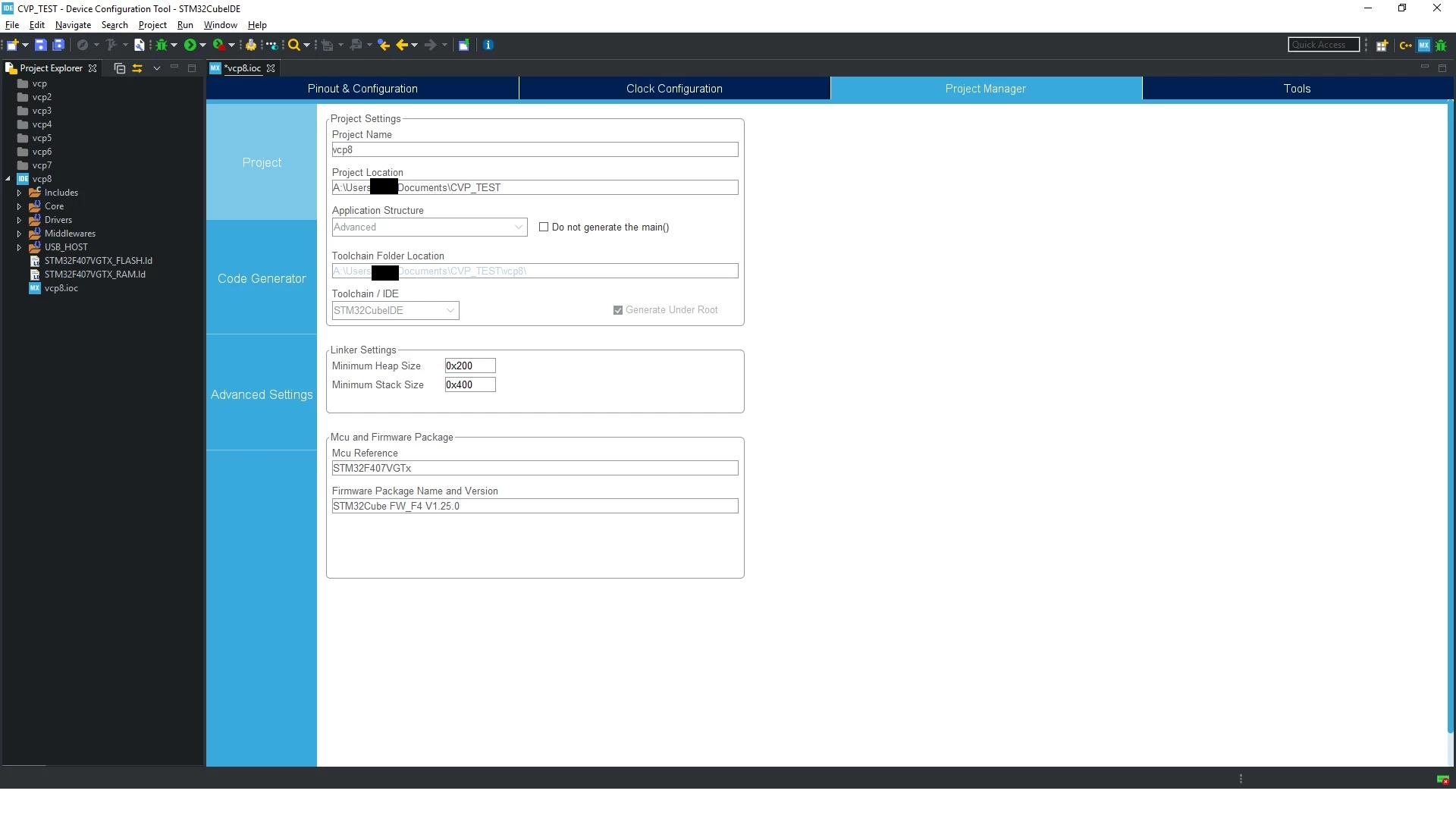

I've also tried increasing the stack and heap sizes, this didn't fix anything. Dose "CDC_Control_FS" need anything additional? all of the switch cases are empty... The USB peripheral is kind of a new concept for me, and I'm getting kinda frustrated.

After a bit more google'n and breakfast. I changed the middleware USB_DEVICE parameter settings. More specifically the Class Parameters, both USB CDC Rx Buffer Size and Tx Buffer size got reduced to 64 bytes. Once I did that everything seemed to work, so.. now I get to figure out what that means... :santa_claus: found Santa, but where the hell is waldo.

Should anybody else stumble upon this post, here are some screen shots of CubeMX, and an example VCP over USB project. Pay close attention to main.cpp & usbd_cdc_if.cpp. (File->Import->General->STM32 Project)
