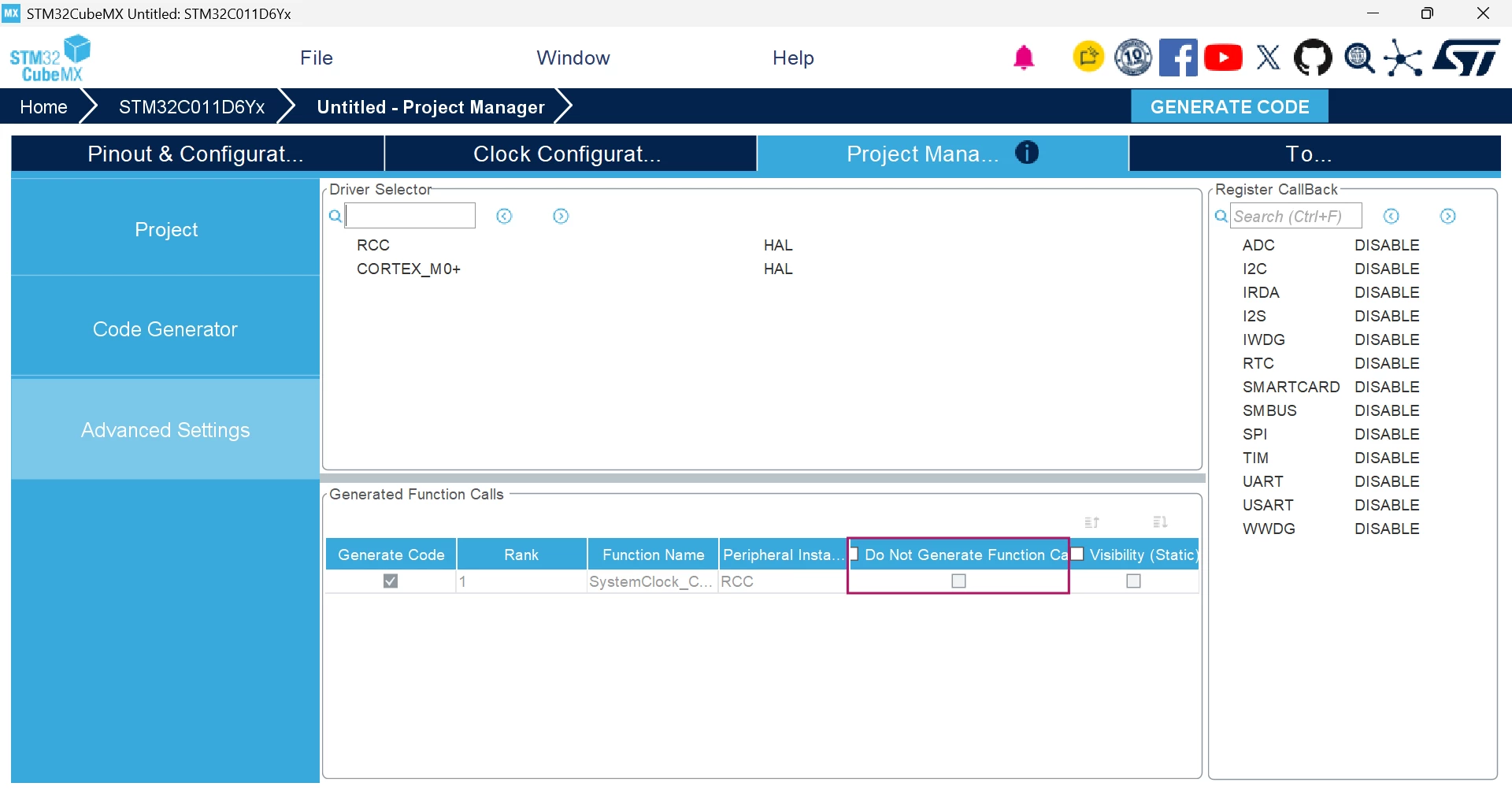

Hi everyone,
I'm working on an STM32 project using STM32CubeMX and noticed that initialization code is generated for peripherals that I don't always use.
Is there a recommended way to configure CubeMX so that only the required peripheral initialization code is generated?
Thanks!

Hello ​@Anacling
Let me thank you for posting and welcome to the ST Community.
You can disable the generation of peripheral code under Project Manager ; Advanced Settings.
Thanks.
Mahmoud

AnaclingAuthor
Aug 21, 2026 11:05 AM UTC
Thanks for pointing me in the right direction! Found the setting in Advanced Settings. Appreciate the help!
