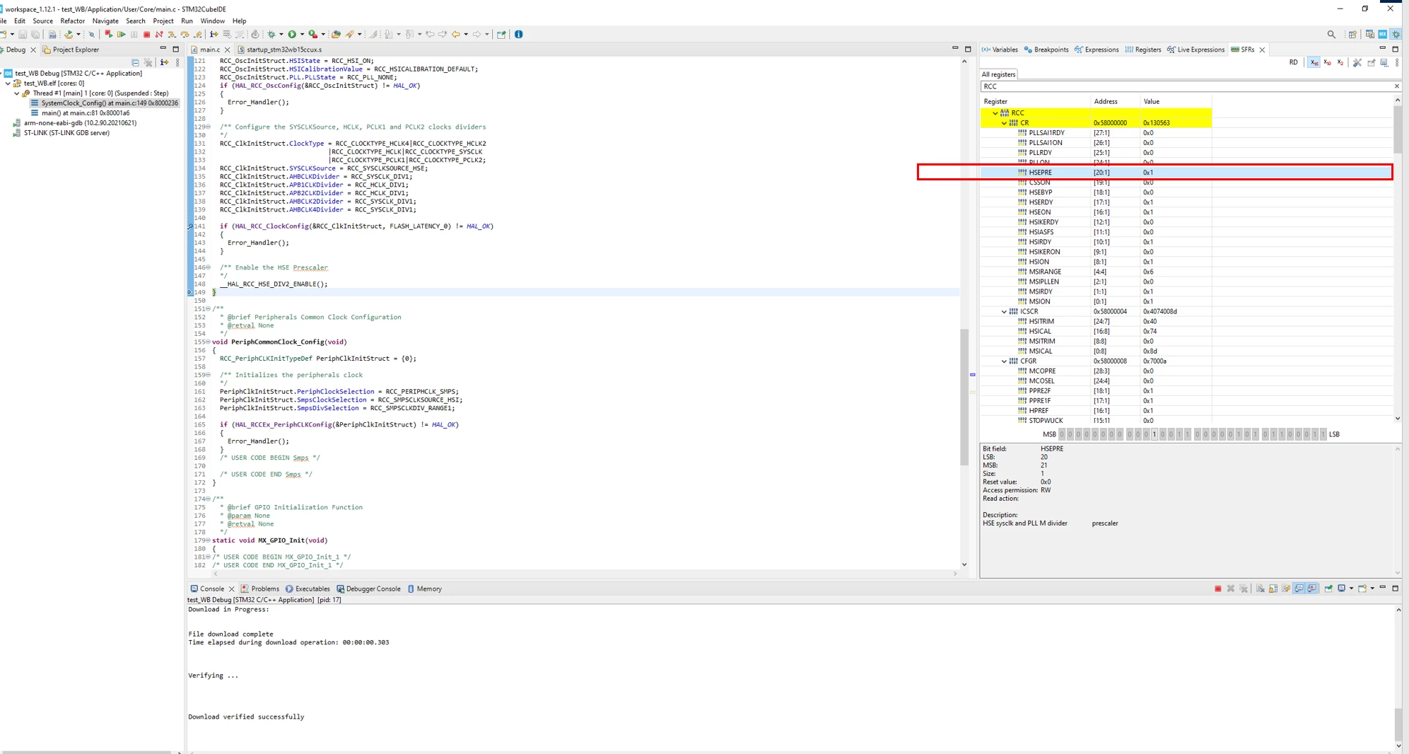

After double check the issue mentioned above , I would like to share with you my results please have a look.
After generating the code (without changing the location of the generated call of function " __HAL_RCC_HSE_DIV2_ENABLE();" ) and debug it

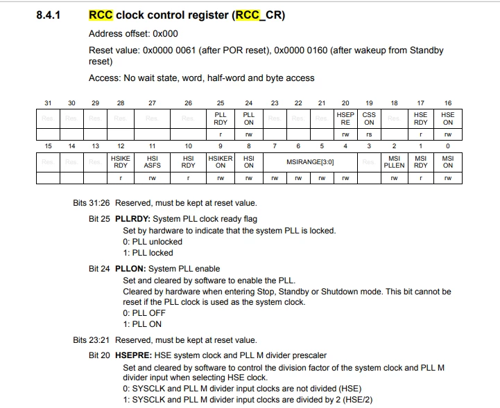

and based on the RM0473 (8.4.1 RCC clock control register (RCC_CR )
The bit HSEPRE=1 as shown in the screenshot that means that the clock divider on the HSE is taken into account when calculation the peripheral clock dividers/periods.
I will be waiting for your feedback .
Thx

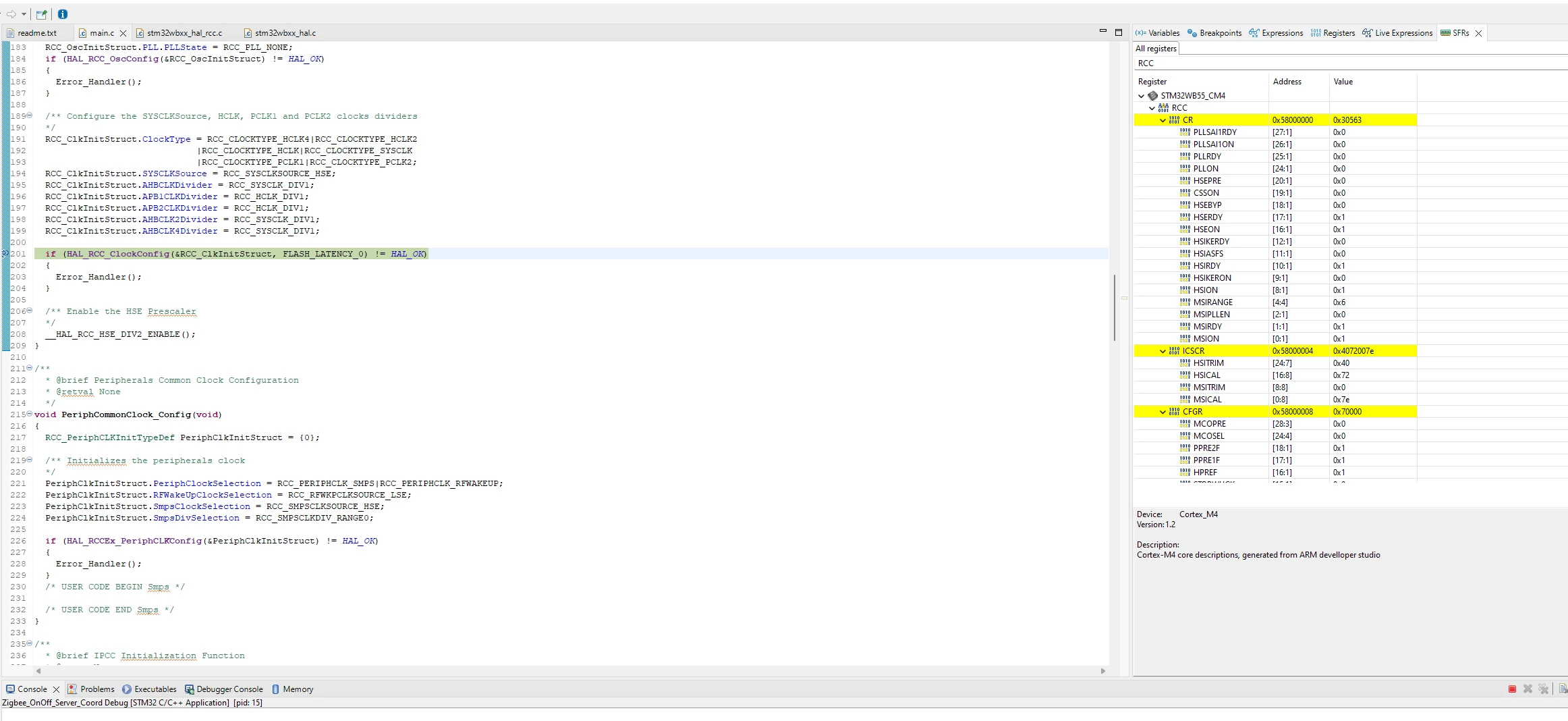

Thanks for the fast response. There was a national holiday in the Netherlands so I could not respond immediately. but I should have given a more in depth explanation.
The HAL_RCC_ClockConfig uses the HSE clock divider to calculate the configuration of the SysTick timer. But as shown in the image below the HAL_RCC_ClockConfig function is called before the clock divider is set.
_legacyfs_online_stmicro_images_0693W00000bkXifQAE.pngthis will cause the SysTick timer to be set without the correct clock config.
another way to see this is:
  • __HAL_RCC_HSE_DIV2_ENABLE() is a define to LL_RCC_HSE_EnableDiv2.
  • To read the Div2 LL_RCC_HSE_IsEnabledDiv2 is used.
  • LL_RCC_HSE_IsEnabledDiv2 is used in HAL_RCC_GetSysClockFreq(void)
  • HAL_RCC_GetSysClockFreq is used in HAL_RCC_GetHCLKFreq
  • HAL_RCC_GetHCLKFreq is used in HAL_RCC_ClockConfig
So if __HAL_RCC_HSE_DIV2_ENABLE is called after HAL_RCC_ClockConfig the div 2 config will not be used in HAL_RCC_ClockConfig. The HAL_RCC_ClockConfig uses HAL_RCC_GetHCLKFreq to set the SystemCoreClock so if the clock divider is changed after the fact, the SystemCoreClock is not set correctly. and that is the same for the SysTick timer set in HAL_RCC_ClockConfig.
With kind regards,
Nick Assink

Hello @NickAssink​
Thank you for your contributions and for your detailed explanations,
I confirm the issue on my side, it has been reported to STM32CubeMX development team .
Internal ticket number:   152728(This is an internal tracking number and is not accessible or usable by customers).
I will keep you posted with updates.
