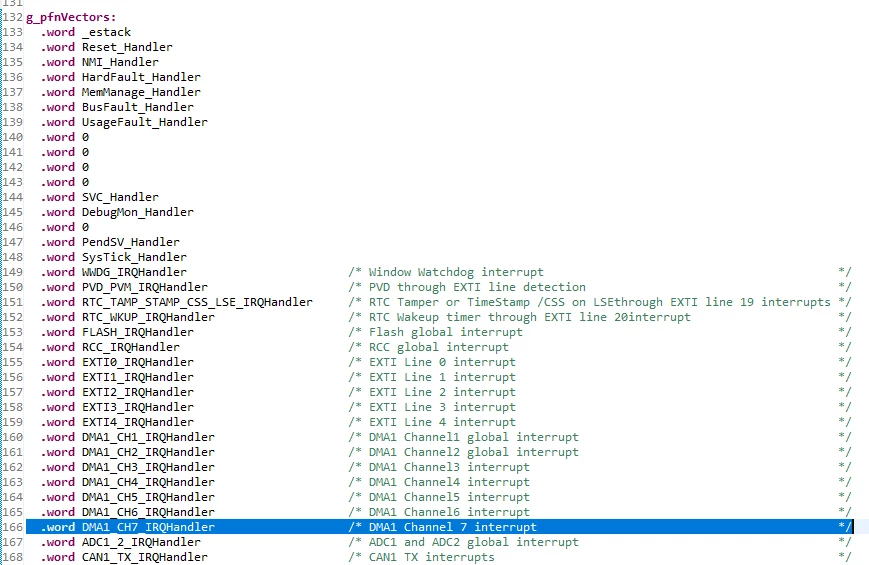

I just started developing software for a new project containing on of the STM32L4P5 series microcontrollers. Therefore I bought the NUCELO-L4P5ZG starter-kit to get used to the IDE, HAL and so on. I use the STM32CubeMX IDE (Version 6.16.1) to configure the board and generate the basic initialization sources. Further code writing is done in STM32CubeIDE (Version: 2.1.1).
For the beginning I configured three GPIO pins for the LEDs on the board and the LPUART for simple data transfer to terminal on host computer. For the transmission I want to use DMA . After generating the code with CubeMX and implementing some simple blink logic for the LEDs, I added the line HAL_UART_Transmit_DMA(&hlpuart1, buffer, 14); to the main loop. I debugged the code and saw that the code ran into the infinite loop in the DefaultHandler in the startup file startup_stm32l4p5zgtx.s:

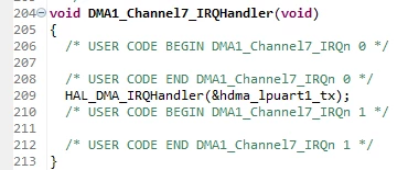

After searching for two and a half hour I finally found the problem: the generated names for the interrupt handler in the startup file and the stm32l4xx_it.c are slightly different. See the following sections:
and
After changing the name manually in the stm32l4xx_it.c file everything works fine (until the next generation of the initialization code with CubeMX).

It appears this bug has been fixed. The code generates correctly on the latest STM32CubeMX version. Update your STM32CubeMX to fix this.

Or, as a workaround, put
#define DMA1_Channel7_IRQHandler DMA1_CH7_IRQHandler
 in a USER CODE block at the top of the *_it.c file.
