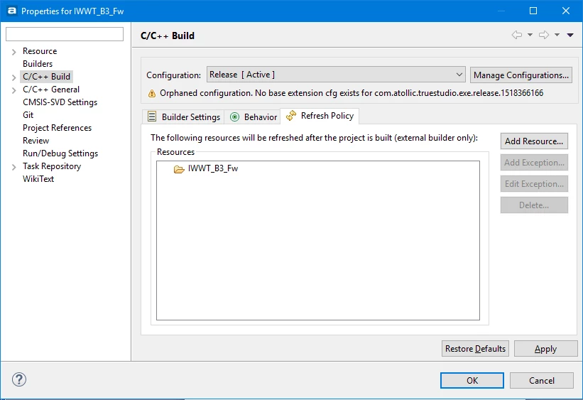

If you generate a project for Atollic and try to use it's Release build configuration, Atollic will show a warning in project settings:
"Orphaned configuration. No base extension cfg exists for com.atollic.truestudio.exe.release.1518366166"
You can reproduce this with a clear project, it happens every time. I'm working with STM MCU's for a year, and inbuilt Release configuration always showing this error.

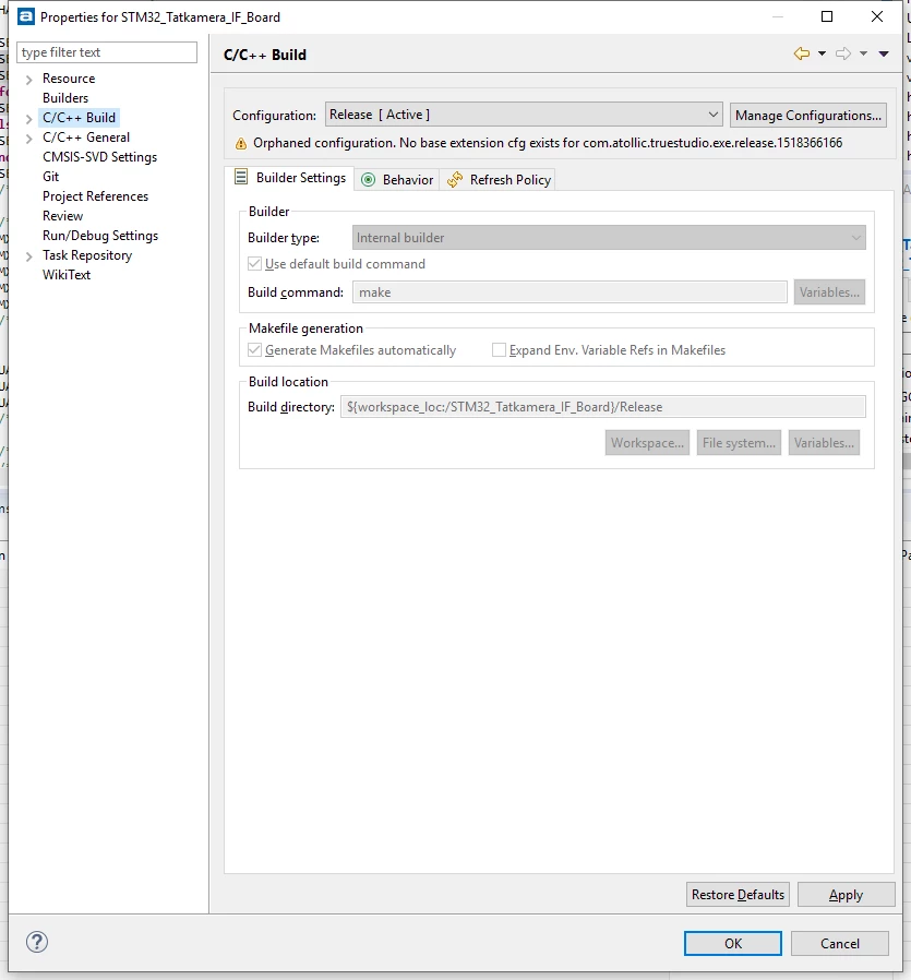

It is fixed in CubeMX 5.2.0. Could somebody else confirm this?
thomast777
Visitor II
Apr 26, 2019 4:59 PM UTC
Confirming fixed for NEW projects. Generated code from an existing project still shows the problem. At least there's a path. I am using this opportunity to check out the new STM32CubeIDE.

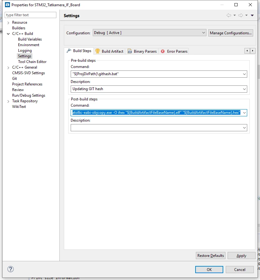

0690X000008AxOeQAK.pngIt works but it kills any custom settings made in the Post-Build steps. as I use this to calculate a checksum and make a flashable Image for the target here, I consider this still as a bug and highly annoying.
CubeMX shall not touch this line when generating / regenerating code.
