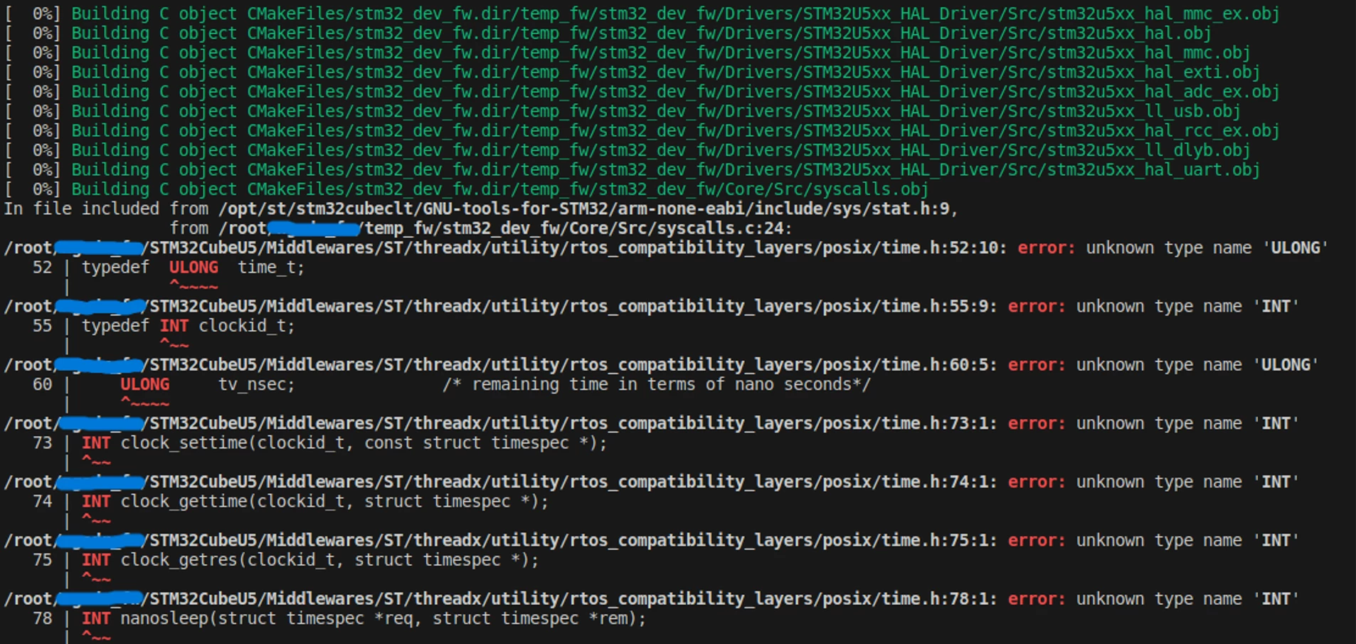

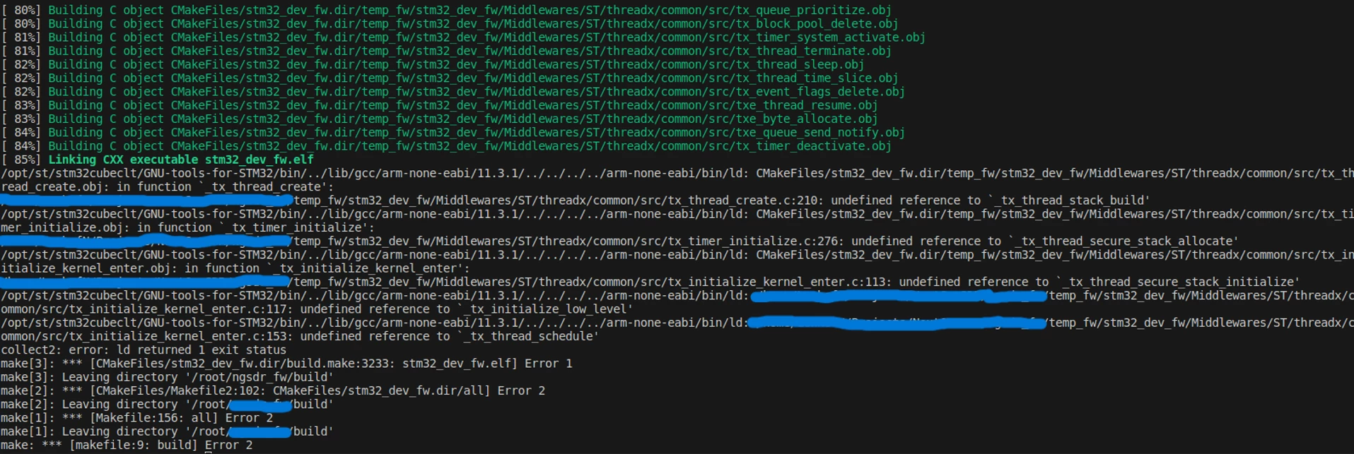

Without cloning the repository and using only the generated files, I get the following errors:
When I clone the repository using:
"git clone --recursive "https://github.com/STMicroelectronics/STM32CubeU5.git" "
"git pull"
"git submodule update --init --recursive"
I get the errors: (Cropped for visibility)

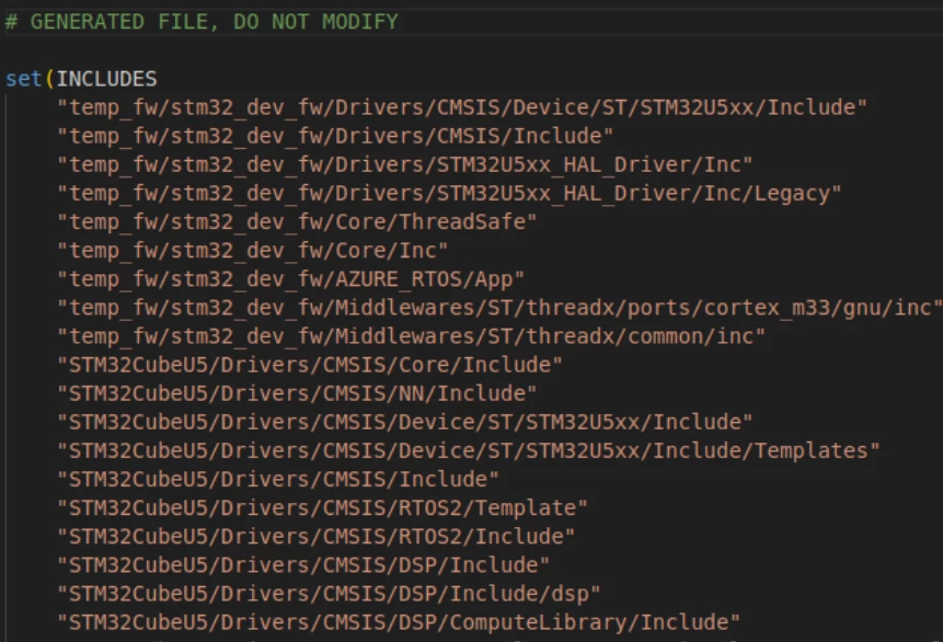

My CMakeLists.txt uses lists of include directories and source files generated from a Python script that recursively starts from a base directory and adds all directories with .h files as include directories and all .c .s and .S files as source files where .s and .S files have property appended for "assembler-with-cpp"  This setup works without any errors without cloning the STM32CubeU5 repository when ThreadX is not used and I am able to run and debug firmware within VSCode.  I need this functionality to continue working when middlewares are added.
In the first scenario only the temp_fw/stm32_dev_fw base directory is used.  In the second scenario both temp_fw/stm32_dev_fw and the git cloned STM32CubeU5 base directories are used.  For example, in the second scenario these are the include paths. (Cropped for visibility)
