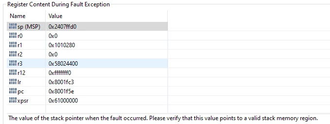

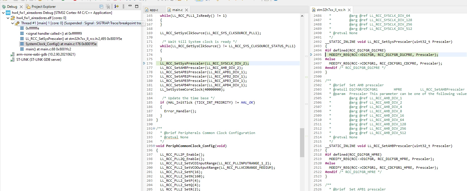

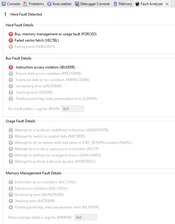

I run a generated code from stm32cube IDE with LL drivers, and the debug process stops.
6 replies
Apr 26, 2022 9:58 PM UTC
Did it hard fault? What do the hard fault registers indicate? Is HSE_VALUE used and set correctly?

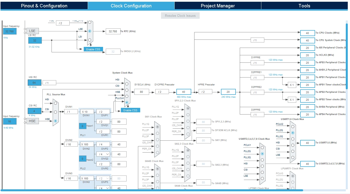

0693W00000Lz8IOQAZ.png0693W00000Lz8ITQAZ.pngHSE is 16Mhz, it is configured correctly in clock
It is a custom hardware.

LL_RCC_SetSysClkSource(LL_RCC_SYS_CLKSOURCE_PLL1);
should be set AFTER
LL_RCC_SetAHBPrescaler(LL_RCC_AHB_DIV_2);
Intermediate AHB prescaler 2 when target frequency clock is higher than 80 MHz
