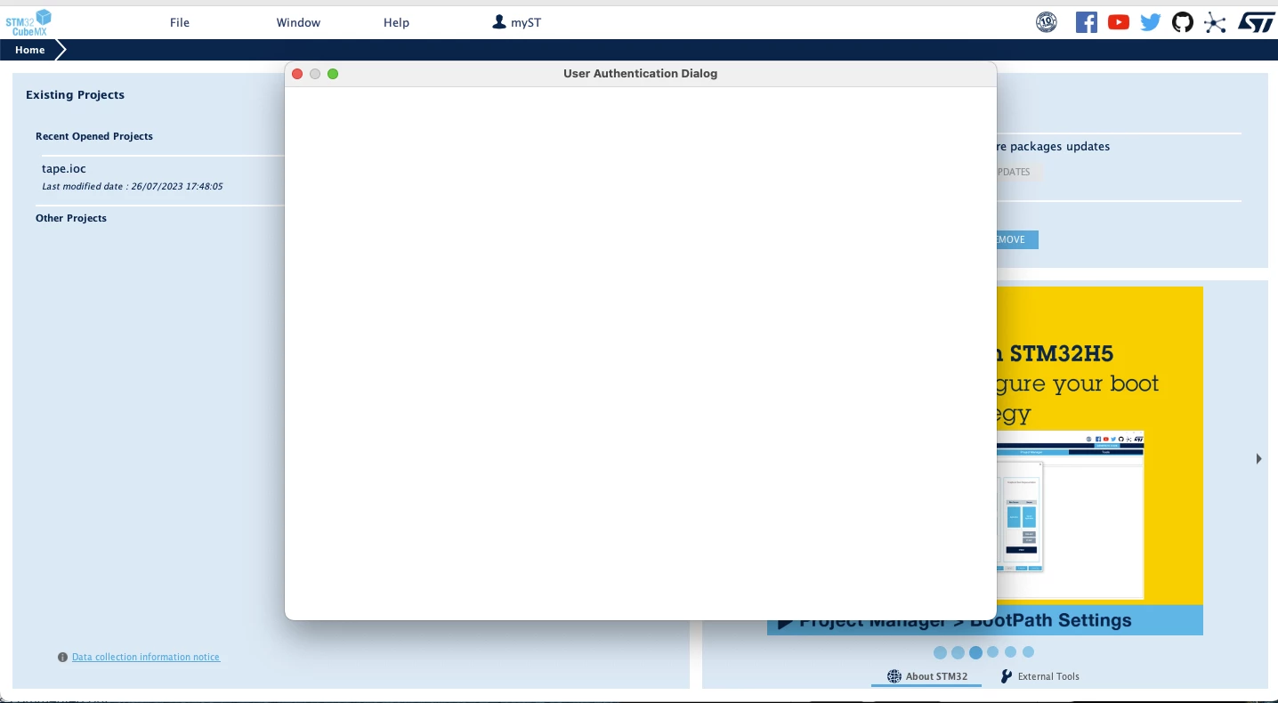

stm32cubemx fails to download packages due to inability to authorize at "myST->login".
According to the crash dump it has happend because of jxbrowser plugin-7.30.2 (chomium version 108.0.5359.215).
All extended attributes had been cleared (not trusted software etc), all neccessary execution bits are set, firewall is turned off.
Please see the log below.
Could anybody help me? Is there any other way to autorise the app?

Hello @dimmorpheus
Could you please try to follow those steps then provide the STM32CubeMX.log:
- Delete user/.Stm32CubeMx
- Run STM32CubeMx 6.9.0
-Click on MyST-->login
-Click on Help -->Updater settings -->Connection parameters --> then check your connection
I will be waiting for your feedback.
Thx
Ghofrane
-MyST-->login
July 28, 2023
Hello. Thank you for the answer.
I'd done all the things you're written.
The same thing.
Please see the content of the 'STM32CubeMX.log' below.
Also I've tried:
- use another Java VM instead of bundled with STM32CubeMX by changing symbolic link '
STM32CubeMX.app/Contents/Resources/jre' to more recent JVM (
20.0.2+9-78).
- use another Chromium build (/.stm32cubemx/.jxbrowser-7.30.2/Chromium).
Nothing helps.

2023-07-28 08:46:45,517 [INFO] WebApp:312 - Starting web application
2023-07-28 08:46:45,517 [INFO] WebApp:520 - Web application path used jar:file:/Applications/STMicroelectronics/STM32CubeMX.app/Contents/Resources/STM32CubeMX!/db/plugins/mcufinder/reactClient1/index.html
2023-07-28 08:46:45,539 [INFO] UserAuth:393 - Internet connection configuration mode: 1
2023-07-28 08:46:45,561 [INFO] CheckServerUpdateThread:120 - End of CheckServer Thread
2023-07-28 08:46:51,387 [ERROR] WebApp:339 - JxBrowser engine crashed! Exit code: 137

2023-07-28 08:46:10,106 [INFO] WebApp:157 - Instantiating new browser for Auth
2023-07-28 08:46:10,164 [WARN] MainUpdater:1189 - Updater busy. Cannot search thirdparties
2023-07-28 08:46:10,164 [INFO] ThirdPartyUpdaterWithRetryManager:96 - Updater plugin is busy. [3/15]
2023-07-28 08:46:10,656 [INFO] WebApp:753 - Register for checkConnection events
2023-07-28 08:46:10,656 [INFO] WebApp:390 - Apply proxy settings
2023-07-28 08:46:10,656 [INFO] WebApp:475 - Chromium requires no authentication
2023-07-28 08:46:10,662 [INFO] WebApp:418 - Direct internet connection detected
2023-07-28 08:46:10,848 [INFO] WebApp:188 - Starting web application
2023-07-28 08:46:10,849 [INFO] WebApp:520 - Web application path used jar:file:/Applications/STMicroelectronics/STM32CubeMX.app/Contents/Resources/STM32CubeMX!/db/plugins/mcufinder/reactClient1/index.html

Hello @scaprile
Chromium crashed while loading libX11.so.6 or libX11-xcb.so.1 library ? Do you have X11 installed?
Thx
Ghofrane
scaprile
November 6, 2023
Of course I have X11 or whatever Ubuntu 20.04 provides as such. However, libx11-xcb1 needed to be installed, that is not a dependency listed anywhere, AFAIK.

Hello @scaprile
It seems JxBrowser now starts and executes some commands. However, there is still an error regarding the missing OpenGL library.
libGL.so.1: cannot open shared object file: No such file or directory
Could you please install it and see if the issue persists?
November 21, 2023
Hello @scaprile,
According to the crash dump, the system ran out of memory. Could you please tell us how much RAM this system has? ​Also, is the application executed directly on the hardware or through some sandbox such as docker or flatpak?

November 21, 2023
Thank you for your contribution!
Let's give ourselves a chance to solve the problem, at least it might help other customers with similar problems.
By default, docker launches containers with a small amount of shared memory (just 64MB, I believe). It is not enough to run Chromium.
The amount can be adjusted with this command line flag: docker run --shm-size=1gb ....
Could you please try it and see if the issue persists?
BR
scaprile
November 21, 2023
Sure !
Added that config to my Docker line and works like a charm so far. That crash disappeared.
