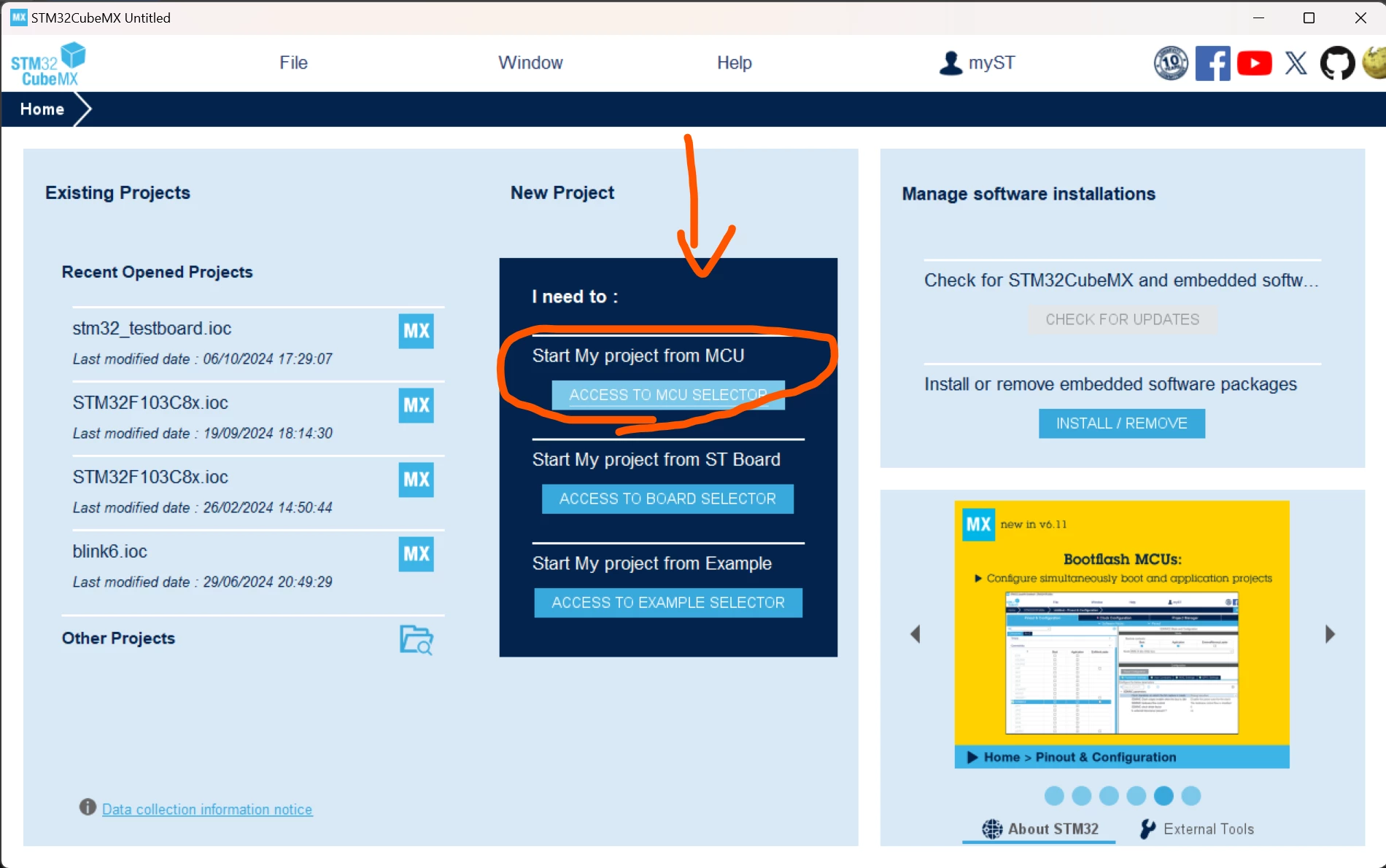

stm32cubemx failed to open ACCESS TO MCU SELECTOR
When I click ACCESS TO MCU SELECTOR, the console prints :
(I tried uninstalling and reinstalling, but the problem persists)
command:jre\bin\java -jar STM32CubeMX.exe -i
output:
2024-10-09 19:44:07,992 [INFO] DbMcus:218 - Found 0 MCUs, 0 are supported
2024-10-09 19:44:07,993 [INFO] ApiDb:423 - Load user favorites file C:\Users\PCH/.stm32cubemx/favorites.mcus.txt: 0 item(s)
2024-10-09 19:44:07,993 [INFO] ApiDb:427 - User favorites MCUs=[]
2024-10-09 19:44:07,993 [INFO] DbMcus:224 - Set 0 / 0 favorites MCUs
Exception in thread "AWT-EventQueue-0" java.lang.NullPointerException: Cannot load from int array because "minMax" is null

stm32cubemx version: 6.12.1
