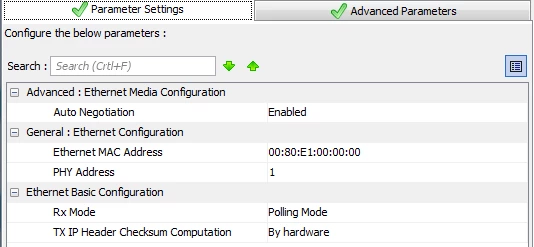

I would like to change the following settings in stm32f1xx_hal_conf.h, which is generated by STM32CubeMX :
#define ETH_RXBUFNB ((uint32_t)8) /* 4 Rx buffers of size ETH_RX_BUF_SIZE */
#define ETH_TXBUFNB ((uint32_t)4) /* 4 Tx buffers of size ETH_TX_BUF_SIZE */
Since there is no USER section in this file, I cant #undef and redefine these.
Here are the available settings in STM32CubeMX:
Nothing in Advanced Parameters as well.
They are indeed very important parameters (RXBUF is set to 8 so Rx_Buff has a footprint of 12kbyte in RAM which is a lot in a 64kbyte RAM device...)
I'm using a STM32F107, with STM32Cube package v1.6.1 and STM32CubeMX software v4.27.0
Please provide a workaround or fix this in the next release ST! :smiling_face_with_smiling_eyes:
Thanks

Hi @motla​ ,
Thanks for your feedback and for willingness to improve STM32CubeMX,
Your request is taken into consideration to be implemented in the upcoming STM32CubeMX version: these parameters would be integrated in the GUI configuration of Ethernet to be handled by users.
Please do not hesitate to contact me for further details,
Best regards,
Mohamed

Hi @motla​ ,
Thanks for your feedback. I have highlighted this internally for further check.
We will come back to you with an answer ASAP :smiling_face_with_smiling_eyes:
Khouloud.

Hi @motla​ ,
Best regards,
Mohamed

What's the status on this feature? It's been 9 month's and I can't seem to find this option in version 5.2.1.
Thanks,
Thomas
