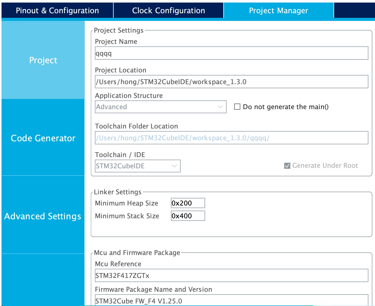

Hwang.11
Mar 8, 2020 7:33 AM UTC
can I generate mdk-arm project by stm32cubeIDE in my MacBook?
"generate under root" is checked!

tsuna
Mar 9, 2020 12:26 AM UTC
I experienced the same problem.
Please try removing "." From the project folder name.
