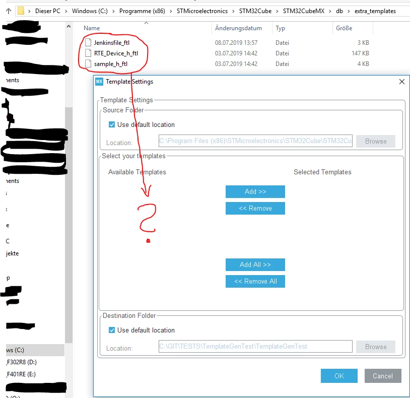

I'd like to use the user template settings (CubeMX Project -> Project Manager -> Code Generator -> Template Settings) to add own files to the generated project, but unfortunately, it neither shows available templates from the (default) extra_templates folder, nor from any other folder I select. There are definitely ftl files located in the extra_templates folder (see attached screenshot)

I have the same issue.
Did you got a solution?

I got around this by:
  1. selecting a custom template folder.
  2. re-select the original folder
