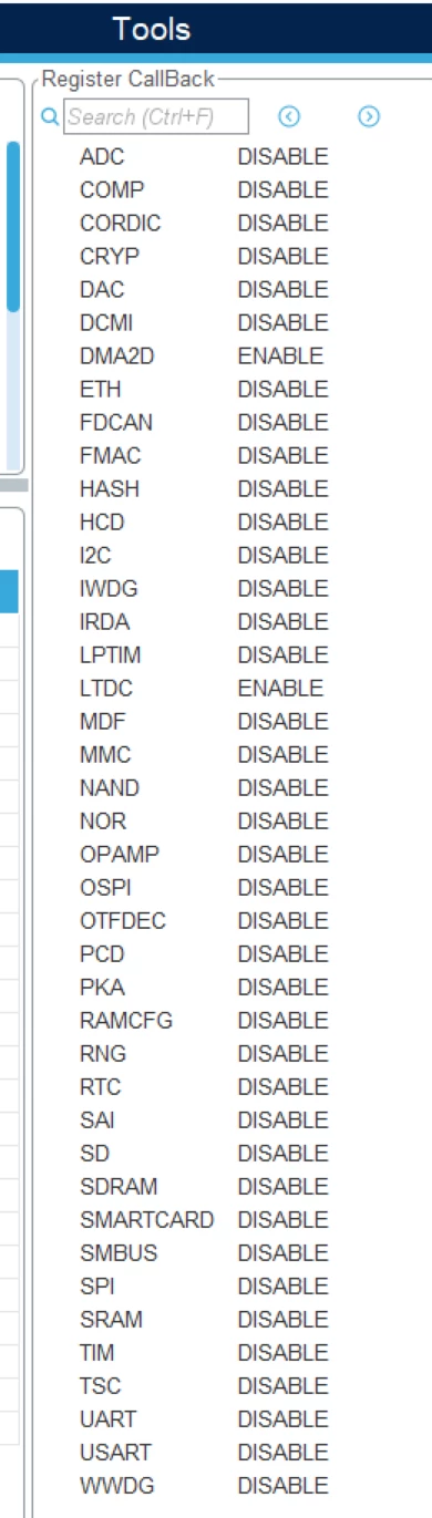

STM32CubeMX do not have the Register CallBacl setting of GPU2D. How to setup?
I use  GPU2D on STM32U599Z .
On CubeMX,
I  checked Activate check box  GPU2D  at "Pinout & Configuration".
and  I saw " Project Manager > Advanced Settings"
There is not GPU2D In Register Callback Groupe.

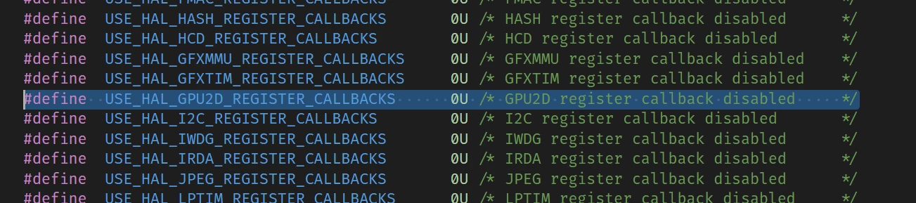

However , The Generated code stm32u5xx_hal_conf.h have  "
#define USE_HAL_GPU2D_REGISTER_CALLBACKS 0U /* GPU2D register callback disabled */
How to set this setting?
