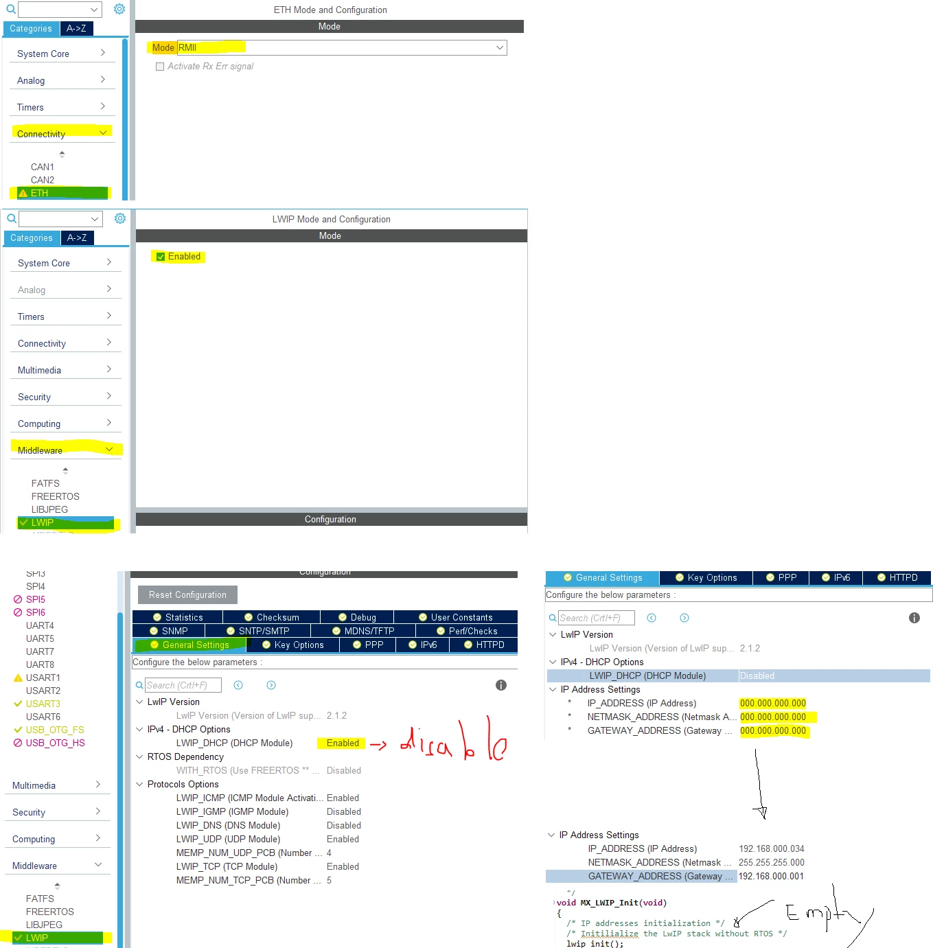

STM32CubeMX didn't make IP & NETMASK & GATEWAY ADDRESS
I Modified General Setting as attaching files, and generated codes. but It's not generated IP & NETMASK & GATEWAY ADDRESS value in MX_LWIP_Init()
It also attached.
I want to know What I did wrong.
2 replies
Khouloud ZEMMELI
Apr 27, 2020 8:14 AM UTC
Hello​ @BPark.4​
Issue already detected and fixed.
The fix will be available for the next CubeMX Release.
Best Regards,
Khouloud
