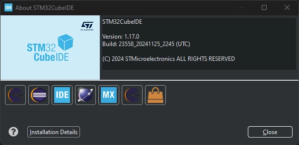

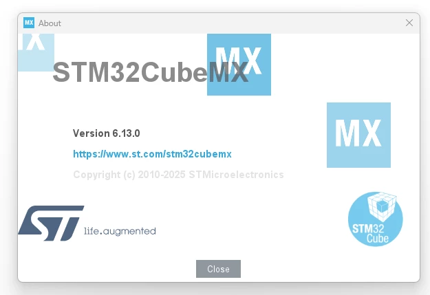

My STM32CubeMX version is:
My STM32CubeIDE version is:
The attached files are from the test project.

Hello @Intector
First let me thank you for posting and apologize for the inconveniency.
In fact this is a known issue with the STM32CubeMX 6.13 version which occurs when activating the memory mapping tool (MMT) and Ethernet.
Unfortunately the only solution is either you disactivate the MMT and make the memory settings manually or use STM32CubeMX 6.12.
A permanent fix will be provided in the next STM32CubeMX release which will be published in the near future.
