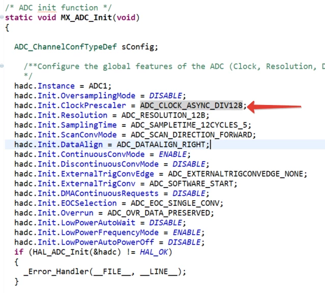

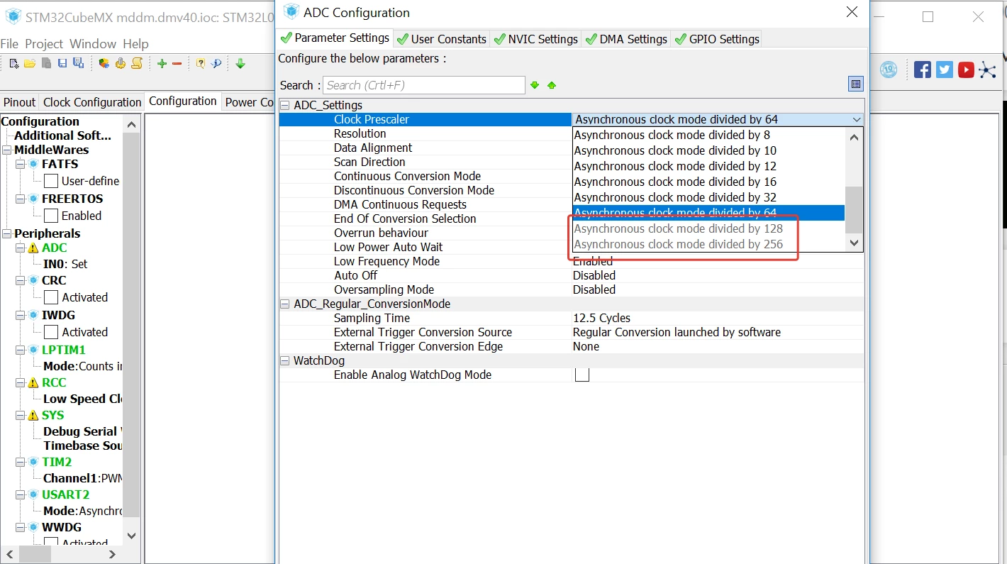

I configured the project for STM32L011 Nucleo board for read ADC input and I noticed that some of frequency devider options were greyed out for some reason).
However I tried to change this setting in the c file with 100% success:
At least the code worked perfectly as was expected.
So the question is: why Cube greyed out this options while being applicable? Is there any method to get the information on why option is grey?

Wouldn't that result in ADC clock frequency below of the minimum given by datasheet?
RMatv
RMatvAuthor
Mar 14, 2019 10:11 AM UTC
Could you make clear what kind of miminum frequency you are talking about? I see this in the datasheet: "When selecting an analog ADC clock frequency lower than 3.5 MHz, it is mandatory to first enable the Low Frequency Mode by setting bit LFMEN=1 into the ADC_CCR register".
So I switched the "Low frequency mode" parameter to "Enable". I suppose that that is it?

According to our development team , the asynchronous clock mode divided by x should respect the Fadc min, max constraint :
the Fadc min, max constraint is :
according to an RCC Parameter: Power Regulator voltage Scale 1 or 2 or 3 we define a max and min Fadc constraint.
the asynchronous/synchronous clock mode divided by x can be selected only if :
Fadc min < ADCClockSynch/x < Fadc max & Fadc min < ADCClockASynch/x < Fadc max.
for example in our case we use STM32L0
-the ADCClockSynch =16 MHz & ADCClockASynch = 2.097 MHZ
- the power Regulator Voltage Scale is set to power Regulator Voltage Scale 1 => that give us a Fadc min = 140 KHz and Fadc max = 16 MHz
we take the example of asynchronous clock mode divided by 4 and the asynchronous clock mode divided by 256
1/
16Mhz / 4 = 4 MHz Fadc min= 140 KHz < 4Mhz< fadc max = 16 Mhz then the asynchronous clock mode divided by 4 can be used .
2/
16 MHz /256 = 62.5 KHz < Fadc min = 140 KHz then asynchronous clock mode divided by 256 not allowed .
that why the not allowed divider are grayed in Mx.
in the c file, the code worked perfectly because all divider are declared and can be used without any problem.
