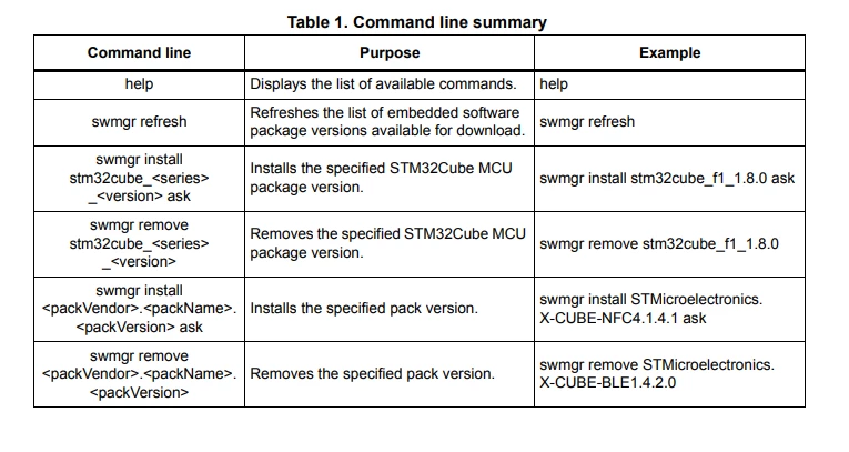

Best answer by Kamil Duljas
Look at example in manual:
https://www.st.com/resource/en/user_manual/dm00104712-stm32cubemx-for-stm32-configuration-and-initialization-c-code-generation-stmicroelectronics.pdf
_legacyfs_online_stmicro_images_0693W00000bjSzPQAU.pngUse:
swmgr install stm32cube_g0_1.6.0 ask
without "FW" and without "V"
