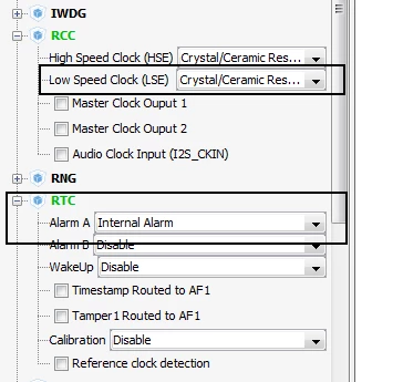

On a project using the STM32F405RGTx with an external 32.768 KHz crystal on the OSC32 pins, the clock config wizard does not allow me to configure the RTC clock mux to use the LSE, although I have appropriately configured the pins as OSC32 and have enabled the LSE in the RCC section of the pinout wizard. The RTC clock mux remains grayed out and cannot be changed from its default setting.

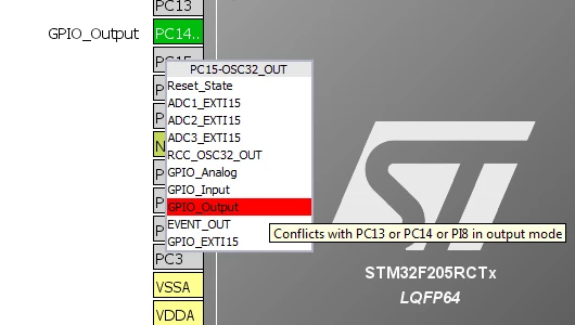

On a project using the STM32F205RCTx (testing the ability of STM32CubeMX to replicate an existing product design for the F2 series), the pinout wizard does not allow me to configure OSC32_IN and OSC32_OUT as GPIO output pins, although the LSE is disabled in the RCC. Since I'm using this exact GPIO configuration in deployed code, I know it's possible to do this, so the GUI tool is wrong.

To have the RTC source MUX enabled for selection, you have to enable the RTC first.
1- RTC issue:
1.1- Enable LSE and RTC in the Pinout view
1.2- RTC Clock source MUX is available for selection
2- GPIO issue
Due to the fact that the switch only sinks a limited amount of current (3 mA), the use of
GPIOs PC13 to PC15 and PI8 are restricted: only one I/O at a time can be used as an
output, the speed has to be limited to 2 MHz with a maximum load of 30 pF and these I/Os
must not be used as a current source (e.g. to drive an LED).
Please let me know if it works for you.
Best Regards
Nawres.
Steve H
Steve HAuthor
Apr 8, 2014 6:24 PM UTC
Posted on April 08, 2014 at 20:24
Thanks, Nawres. I was able to get the RTC configuration working, and I ultimately found the datasheet note on PC13-15.
