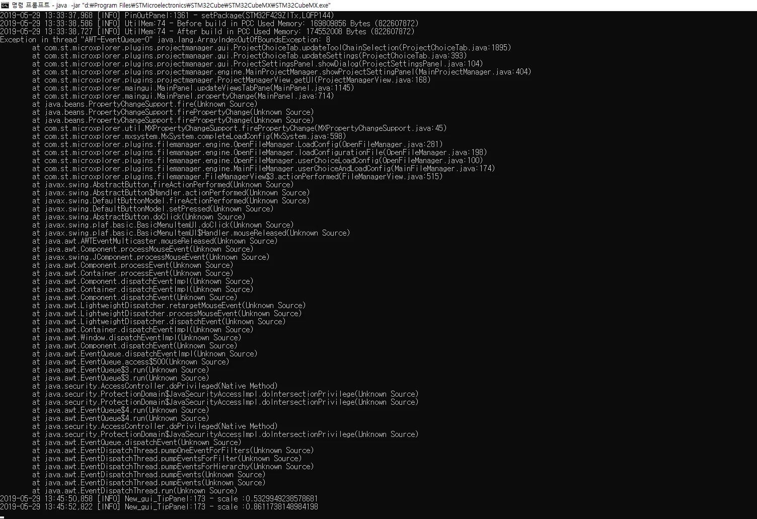

STM32CubeMx can't load project - freeze
hi.
When I try to open the project file, it does not respond and it does not go any further.
Perhaps this is happening since the update.
​attaching debug information, please confirm.

​Hello @HJung.6​ ,
You're right , issue will be fixed in the next release.
For the moment :
1-Open CubeMX
2-Create new project : choose any MCU
4-Then load your project
-> it will be opened
this's a provisional solution.

thanks. it's working.
