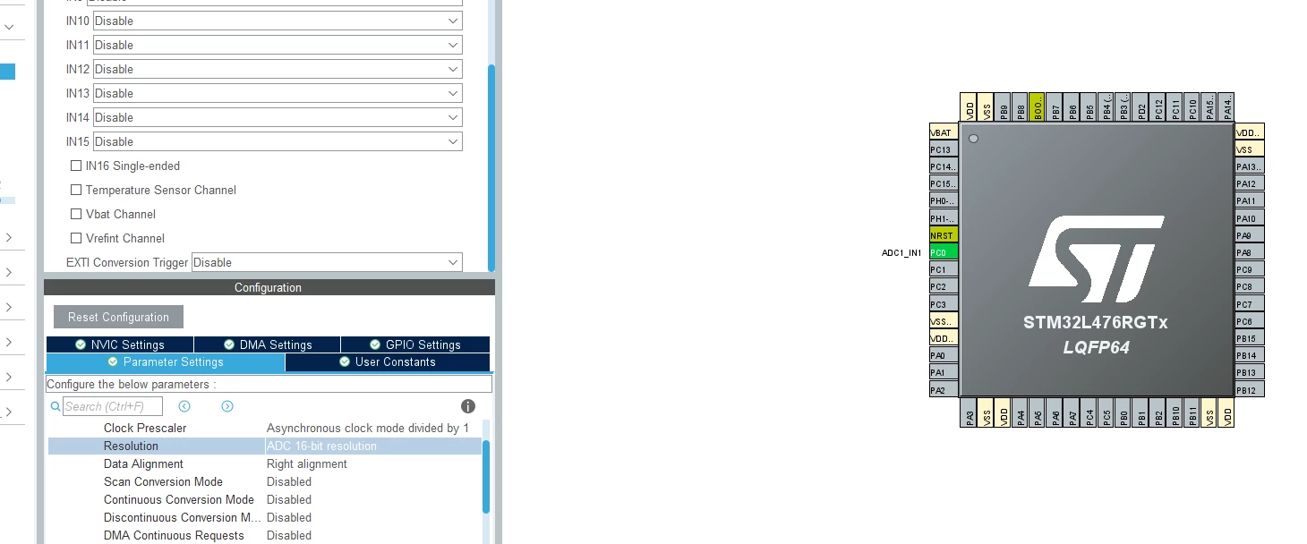

I notice that CubeMx allow choose 16-bit resolution but STM32L476 has range from 6 to 12 bit.

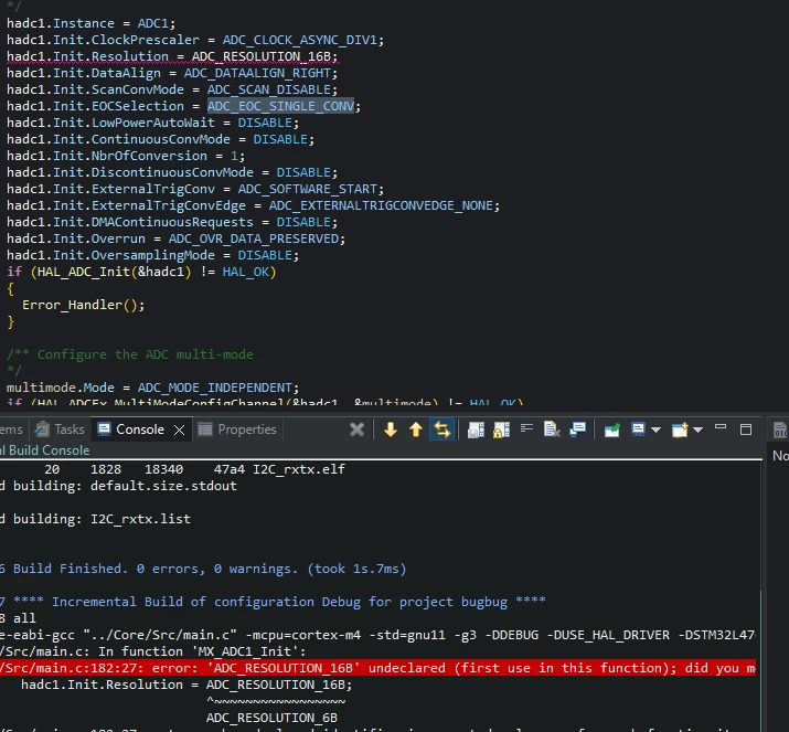

When I generate code I can't compile it:

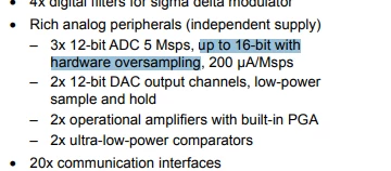

_legacyfs_online_stmicro_images_0693W00000bj283QAA.pngMoreover in datasheet we read on page 1:
but it's only one information about mystic 16-bit resolution :D

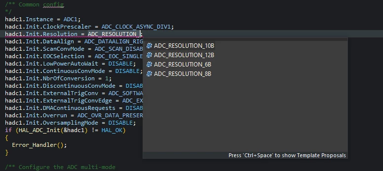

Best answer by Kamil Duljas
Pleas look at my first post. CubeMx generate ADC_RESOLUTION_16B that not exist in ADC header for this board .
https://github.com/STMicroelectronics/STM32CubeL4/blob/e691a513a48d0014f201ce35a265cbfca446396d/Drivers/STM32L4xx_HAL_Driver/Inc/stm32l4xx_hal_adc.h#L465

Well, we are talking about a 12-bit ADC with hardware oversampling.
In the generated code you will find at the very bottom: hadc1.Init.OversamplingMode = DISABLE;, which is set by the CubeMX setting in "ADC_Regular_ConversionMode". You will get 16bit oversampling when enabled.
Does it answer your question?

I don't think so. CubeMx should not generate code that you can't compile it​

Hello All,
Issue confirmed and an internal ticket (ID 150960) is submitted in order to fix this.
(PS: ID 150960 is an internal tracking number and is not accessible or usable by customers).
Thank you for your contribution.
