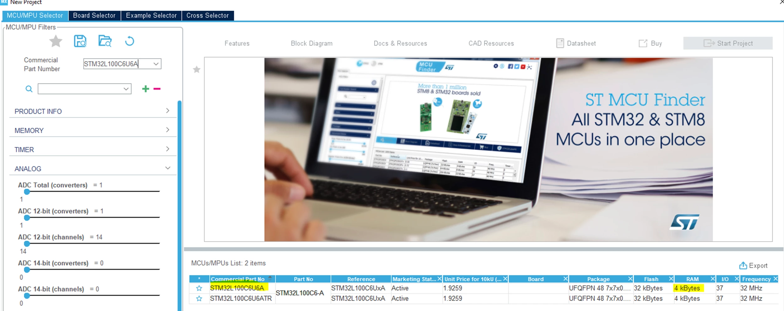

STM32CubeMX bug? STM32L100C6U6A 4 kBytes RAM but linker script says 16 kBytes
  • January 27, 2026
  • 203 views
I select a new project and select the STM32L100C6U6A. STM32CubeMX says it has 4 kBytes of RAM.

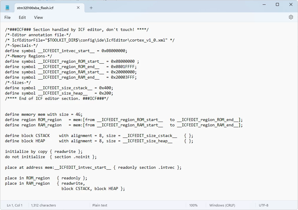

I generate the project for EWARM.
But when I generate the project for EWARM it puts stm32l100xba_flash.icf file in the project and that files says RAM is 16384 bytes.

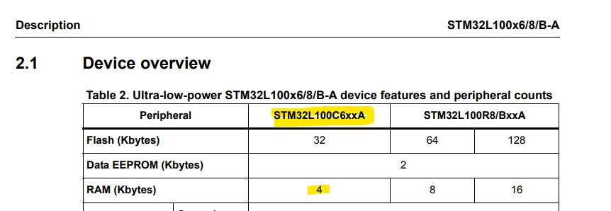

And the datasheet for STM32L100C6U6A says 4 kByte.
Is this a bug in STM32CubeMX?
My application still seems to run without errors. IAR reports 9511 bytes of readwrite data memory used.
Why does it still work? Is the datasheet wrong and this device is actually delivered with 16 kBytes RAM?

How can I track this ticket number? How do I get an explanation?
We have a finished product where this could become a problem as we use too much RAM (9511 bytes), but our testing has not showed any errors in function.
