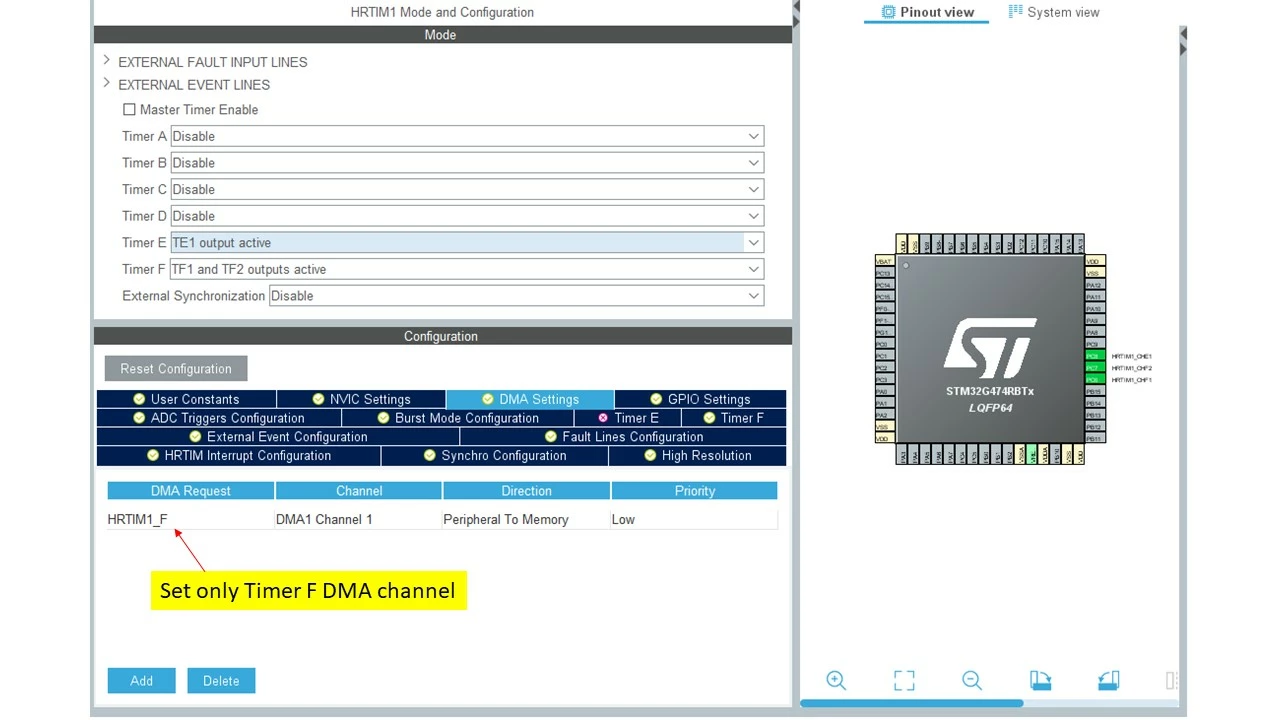

STM32CubeMX bug? STM32G474 HRTIM Timer_F tab could not be set any DMA Request Sources, on the other hand Timer_E tab got an error.
  • April 20, 2020
  • 1 reply
  • 1141 views
I am working with a STM32G474RE and I want to use HRTIM Timer F as PWM with DMA transfer.I used STM32CubeMX Ver.5.6.1 and CubeG4 FW V1.2.0 for generate simplest init. code, which would work only for HRTIM function for HRTIM Timer F.
here's my setup and problem.

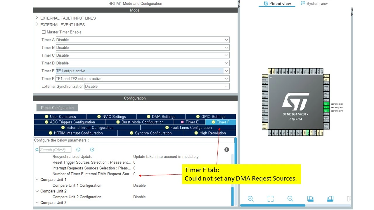

In the Timer F tab:
Could not set any DMA Request Sources. This form always returns to 0 automatically.

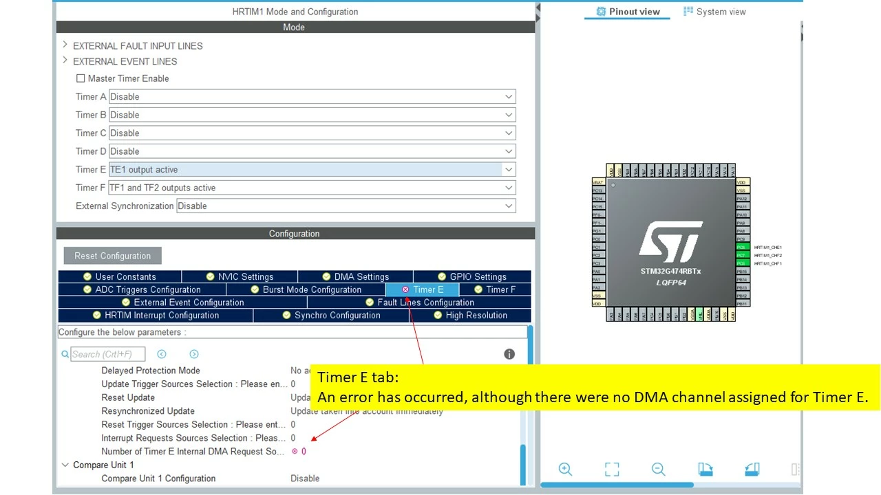

In the Timer E tab:
An error has occurred, although there were no DMA channel assigned for Timer E. (Timer A ~ D has no error if those were enabled)

1 reply
Imen GH
April 21, 2020
​Hello,
I raised internally your reported case to take in consideration .
Regards
