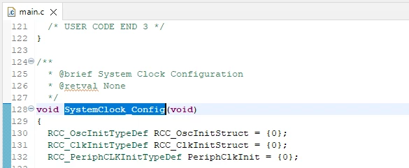

Dear ST support team,
In STM32CubeMX under the "Project Manager - Advanced Settings" path in the "Generated Function Calls" window user can select to make the generated functions' scope static or external. However, the SystemClock_Config() is always static within the main.c where this function is also generated. This is a bit annoying for all of us who do not use the main() function in the main.c and want to call all the required HAL initializations externally. This issue seems MCU family independent.

@lgacnik97 wrote:
the SystemClock_Config() is always static within the main.c where this function is also generated. !
I see it in main.c, but it's not static:
But is it also not prototyped in any generated header - which does seem inconsistent.
