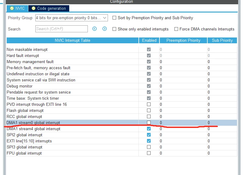

STM32CubeMX bug for Save Project
0693W000004IBAsQAO.pngI disable “DMA1 stream0 global interrupt�?,and then click Fiel-》save project ,then close STM32CubeMX。
But when I open the project next time, “DMA1 stream0 global interrupt�? is still enabled。
I do not know why? hwo can help me,think you�?

You are still using an old version (5.6.1) of CubeMX, which indeed had a bug here. Please upgrade to the most recent version of CubeMX to get your issue fixed.
Good luck!

You could give us some more information: which device, which peripherals are used, especially which middleware you have enabled, etc.
Of course it stays enabled if there is anything using this interrupt.

This is the project  package,Please help me look over my problems,thank you�?
Good luck!
