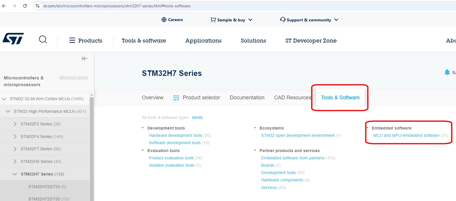

Now we know the family ...
Go to the 'Tools and Software' tab, click 'MCU and MPU embedded software':

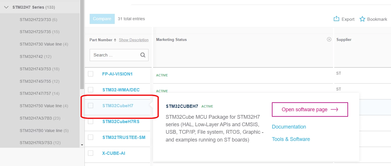

You want the STM32CubeH7 pack:
The User Manual is on the software page, 'Documentation' tab:
https://www.st.com/en/embedded-software/stm32cubeh7.html#documentation
