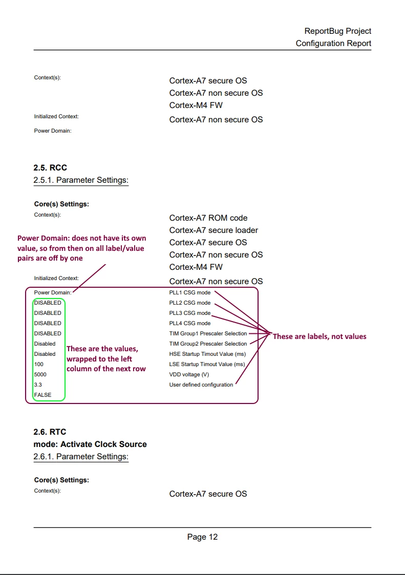

The otherwise excellent STM32CubeMX tool has a bug in its Configuration Report output (reached via the File > Generate Report command). In the Peripherals and Middlewares Configuration section of the report, the left and right columns of the output are reversed or (more likely) line-wrapped.
See attached screen shot for an example -- this continues for many pages.
I could not find a better way to report this, so could the developer of this STM32CubeMX tool please to look into this issue, because it makes the report output very awkward to interpret.
Note that the STM32CubeIDE suffers from the same problem; it probably uses the same report generator.

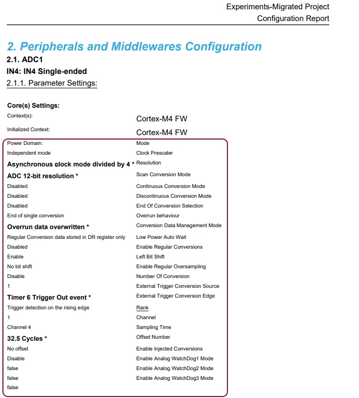

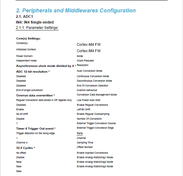

It still doesn't explain why the output gets wrapped onto the next line in all my output; there is nothing unusual that I can see. Compared to @Sarra.S 's sample output the problem starts right after "Power domain:" and then seems to stay out of sync.
Even the "Asynchronous clock mode..." phrase, which really is a configuration value, is being formatted as a subheader instead of a value.
Name/values get out of sync after "Power domain:"Name/values get out of sync after "Power domain:"
It looks as if the bit after "Power domain:" causes the trouble: it is followed by "mode" as well as "Independent mode".
My new guess is therefore that the label should have been "Power domain mode:" followed by its value "Independent mode", but that the label got split into two parts, inadvertently creating a spurious value of "mode", and thus creating a one-off displacement for each subsequent label and value.

The Report generator creates an off-by-one label/value mismatch after each "Power Domain:" label in the report. The "Power Domain:" label itself never has a value (which is probably the source of the problem), causing subsequent label/value pairs to be shifted one position, such that the labels end up in the right-hand column and their values in the left-hand column on the next line. See this screen shot:
Off-by-one label/value errors after Power Domain: label without its own valueOff-by-one label/value errors after Power Domain: label without its own value
