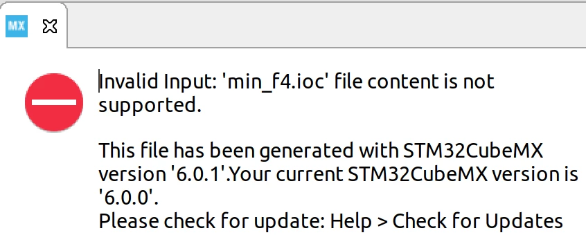

A version mismatch prevents me from inspecting the .ioc file generated by CubeMX in CubeIDE:
" This file has been generated with STM32CubeMX version '6.0.1'.Your current STM32CubeMX version is '6.0.0'. "
If CubeMX is following semantic versioning, then it looks like this is just a PATCH bump, which should be backwards compatible. If it's not backwards compatible, then what do these numbers even mean?
Also, I'd simply update the IDE if that was not blocked by this other issue: https://community.st.com/s/question/0D53W00000Gj2OYSAZ/how-to-update-stm32cubeide-on-linux

Hello Mf.1,
Can't reproduce the issue from my side.
working environment:
  • Os : Windows
  • STM32CubeMX version: 6.0.1
  • STM32CubeIDE version :1.4.0
Otherwise, when creating a CubeMX project using the latest version v 6.0.1 of STM32CubeMX , it will not be possible to load this project using older versions of CubeMX ( v 6.0.0 for example).

Some additional system details:
  • Os : Ubuntu 20.04
I figured-out how to update STM32CubeIDE to 1.4.2 (required root, see other thread), and that fixed the problem.
Still curious what to expect from the versioning numbers in CubeMX. Seems like the digit locations don't convey any particular meaning.
