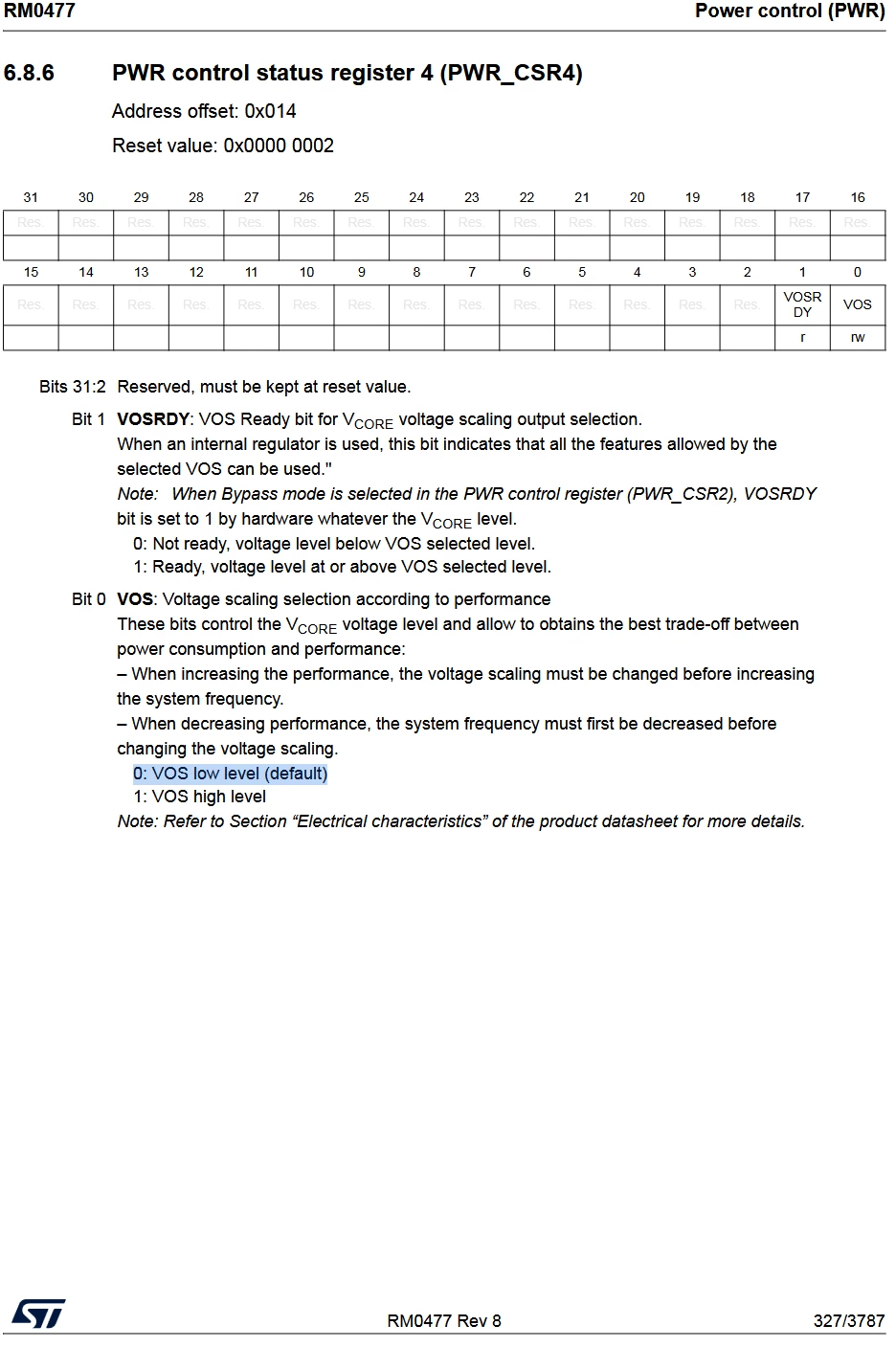

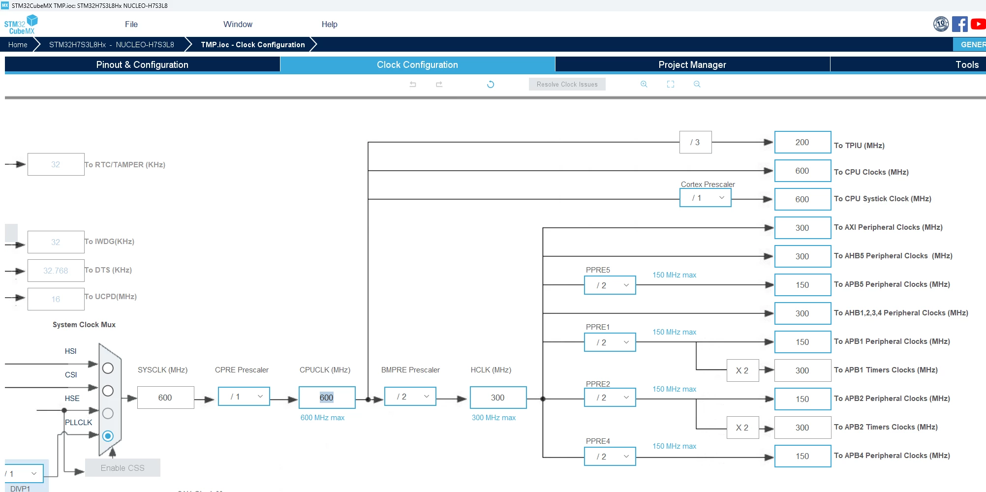

I'm using the NUCLEO-H7S3L8 and the max CPU frequency is 600MHz.

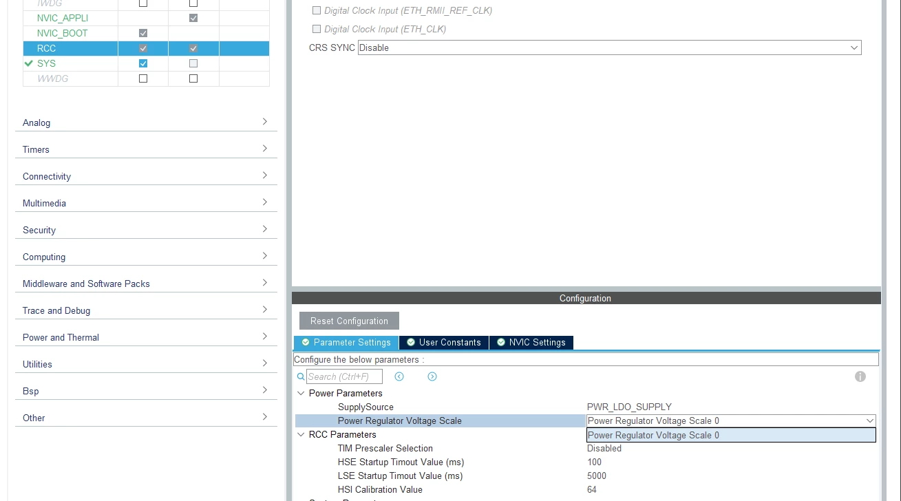

By default, CubeMX sets VOS is set to 0 (low).

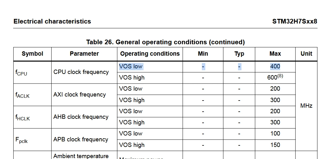

But if this were the case, wouldn't it be violating the datasheet where it states 400MHz is the max CPU clock?
I've been using 600MHz clock without ever setting VOS high and I haven't gotten any issues, so I'm not sure whether or not it's fine to leave VOS alone.

I think it is indeed backwards, but the documentation is also a bit inconsistent about this.
If the RM says VOS=0 is "low level", this would naturally map to mean "VOS low", and as the DS page I shown above, "VOS low" implies FCPU MAX of 400MHz. Funny stuff.
