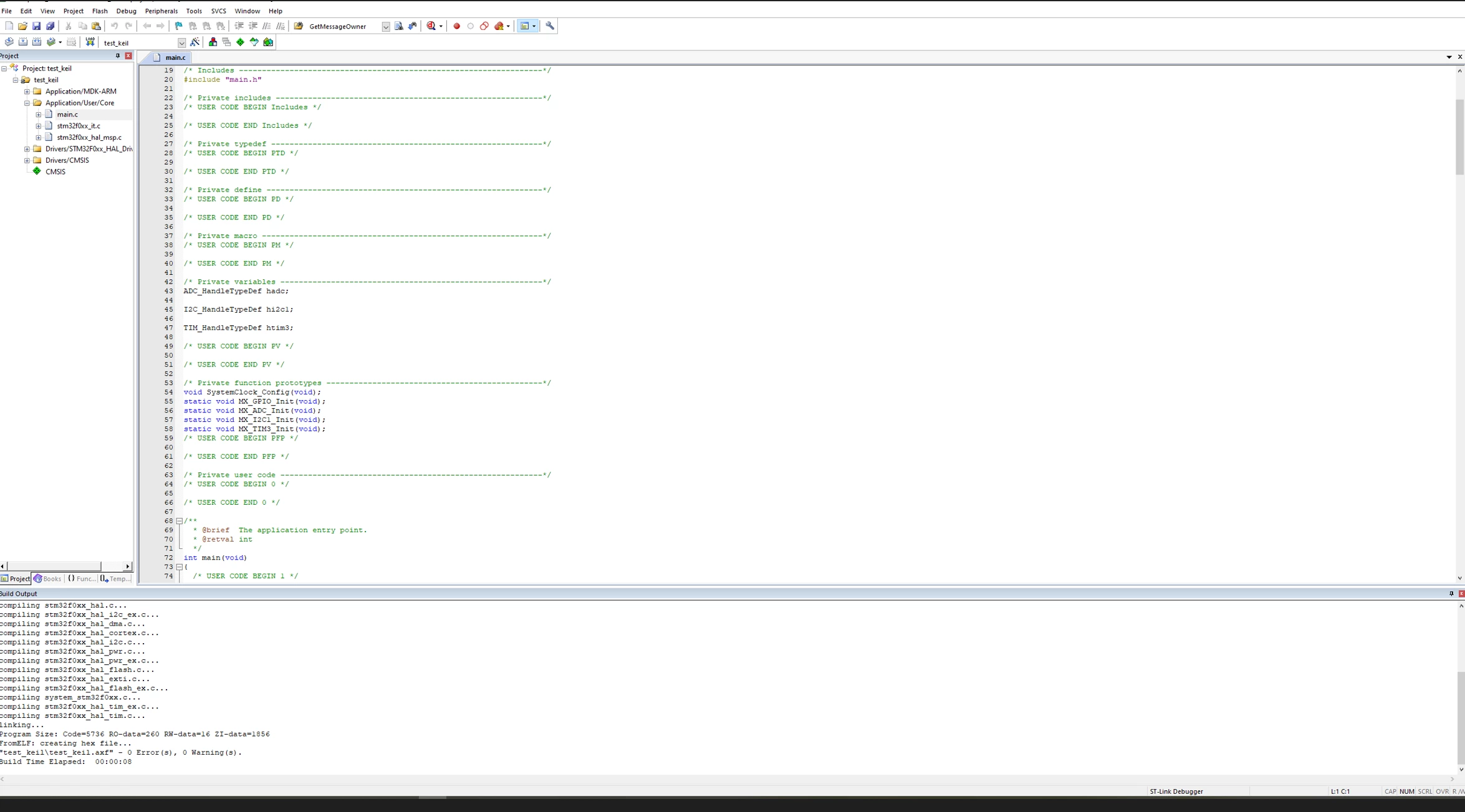

Ghofrane GSOURI
August 29, 2023
Hello @Bernt
Actually I created a project based on STM32F030R8Tx using CubeMX 6.9.1 where I activated few IP then I generated and built the code using keil , this is what I  got  0 errors 0 warnings
Could you please provide your ioc in order to push further the investigation.
Thx
Ghofrane
