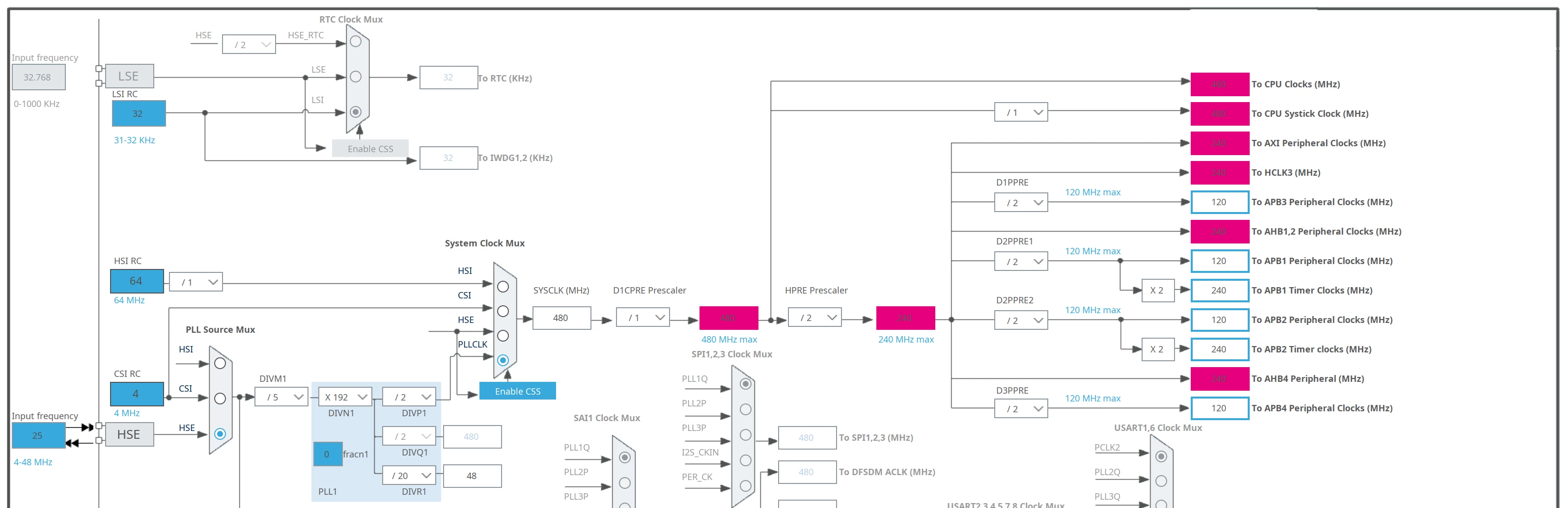

I'm seeing incorrect behavior in the Clock Configuration screen. It is flagging valid values as being out of range (STM32H743XIH6). Is anyone else seeing this? If I save and re-start CubeMX, I still see the same problem.

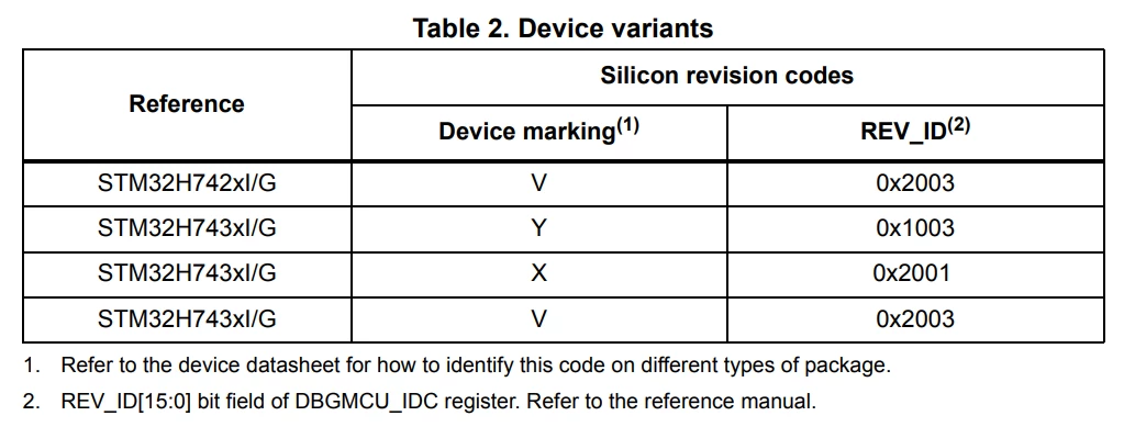

Hello @chriscole​ ,
For the STM32H743 , we have 3 revision :
Use silicon revision V devices to reach a maximum frequency of 480 MHz.
Foued

OK I found the reason -- I had silicon rev Y selected (has max core clock speed of 400 MHz) instead of V (supports max core clock speed of 480 MHz). It was non-obvious to me what the problem was, perhaps the reason can be displayed when you hover the mouse over the red boxes.
