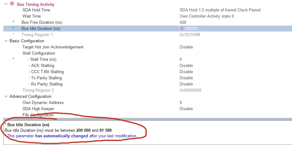

I'm also having issues with the UI when enabling the I3C peripheral, it complains about the Bus Idle Duration but the range is invalid, see attached.
What is wrong? 200292 is not between 200000 and 81588.
DClif.1
Mar 19, 2023 8:34 PM UTC
two things:
1) the low number should be first.
2) if you enter a number within the range it rejects it, if you enter a number higher or lower than the range it rejects it too.
