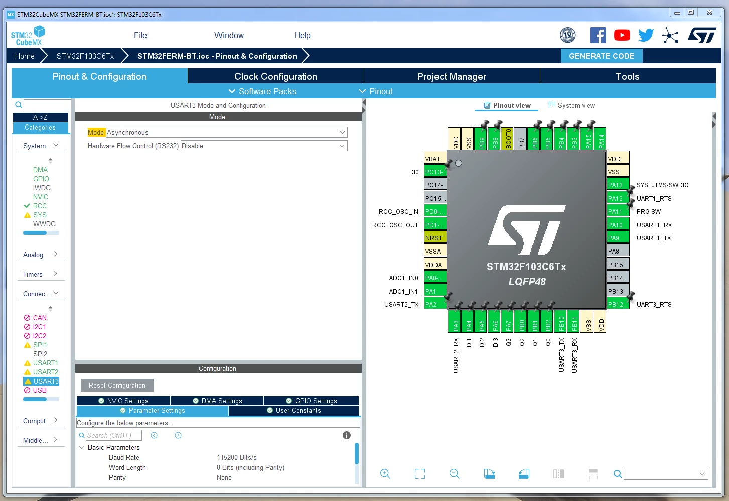

Welcome, @IZapr.1​, to the community!
Regardless of the fact that STM32CubeMX 6.7.0 is already outdated, I restarted my installation of 6.7.0: no USART3 is listed for STM32F103C6T, only USART1 and USART2.
Please describe how you got USART3, with screenshots if you like.

IZapr.1
IZapr.1Author
March 21, 2023

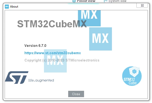

Peter BENSCH
March 21, 2023
Very interesting, only the medium, high and xl density devices contain a USART3. However, the STM32F103C6T is a low density one and does not have a USART3. Can you please upload a screenshot from Help > About?
Which version of the firmware package are you using?
IZapr.1
IZapr.1Author
March 21, 2023
