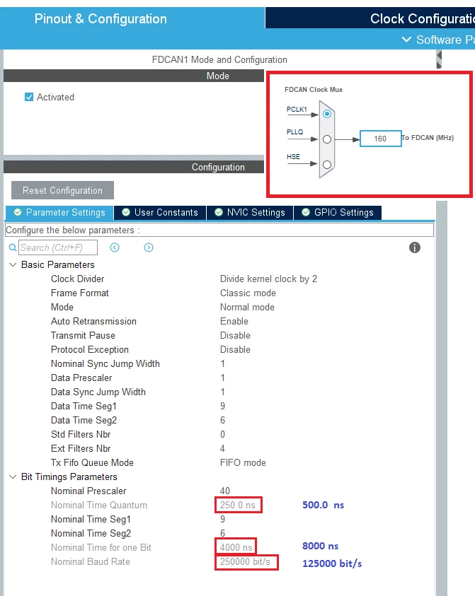

STM32CubeMx 6.6.1 show wrong FDCAN Parameters Setting
The latest version of STM32CubeMx 6.6.1 organizes the parameters of the FDCAN differently from the previous version and shows useful information on Time Quantum, Time for one Bit and Baud Rate.
But I think the displayed parameters are wrong, as shown in the attached image.
In my case the micro used is STM32G473VBTx

Hello @Community member​
First le me thank you for having reported.
Actually you're right, I've been able to reproduce the same misbehavior from my side when using the same configuration as you.
I also used the following formula found in the ref manual RM0440 Rev 7 under 44.3.1 Bit timing paragraph and I found the same results as yours.
With this being said, this problem is raised internally to be reviewed. I'll keep you posted with the updates.
Internal ticket number: 131711 (This is an internal tracking number and is not accessible or usable by customers).
Thanks for your contribution.
Semer.
