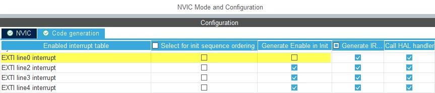

STM32CubeMX 6.6.1 "Generate Enable in Init" does not work as expected for external interrupts
When attempting to initialize a single GPIO EXTI as disabled, the generated code still enables the interrupt. I did notice that if I uncheck all of the EXTI lines, then none of them are enabled in the generated code. So it seems it's all or nothing. Is this the expected behavior?
Thanks,
Frank
This:
0693W00000QLTFGQA5.pngGenerates:
 /* EXTI interrupt init*/
 HAL_NVIC_SetPriority(EXTI0_IRQn, 5, 0);
 HAL_NVIC_EnableIRQ(EXTI0_IRQn);
 HAL_NVIC_SetPriority(EXTI2_IRQn, 6, 0);
 HAL_NVIC_EnableIRQ(EXTI2_IRQn);
 HAL_NVIC_SetPriority(EXTI3_IRQn, 6, 0);
 HAL_NVIC_EnableIRQ(EXTI3_IRQn);
 HAL_NVIC_SetPriority(EXTI4_IRQn, 6, 0);
 HAL_NVIC_EnableIRQ(EXTI4_IRQn);

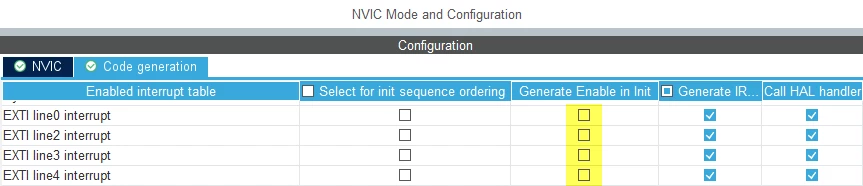

However, this:
0693W00000QLTFfQAP.pngGenerates:

Hello @FLomb.2 (Community Member)​ & @KnarfB (Community Member)​ ,
Thanks for your feedback,
This is a known issue and it is already raised to the dev team. When "Generate enable in init" is unchecked, its respective HAL_NVIC_EnableIRQ(XXXX_IRQn) should not be generated.
I will keep you posted with updates
Internal ticket number: 129363 (This is an internal tracking number and is not accessible or usable by customers).

KnarfB
July 19, 2022
Confirmed on NUCLEO_STM32G431KB PA4 and PB0. Flagged as bug-report.

Sune Jensen
December 13, 2023
The call to HAL_NVIC_EnableIRQ(XXXX_IRQn) seems to be correctly omitted when the initialization code is generated in main.c. It is erroneously called when the initialization code is generated in gpio.c.

December 2, 2025
The problem still exists in CubeMX Version V6.16.0. With STM32L496 and "generate peripheral initialization as pai of .c/.h files per peripheral" checked
Ghofrane GSOURI
December 2, 2025
Hello @lbrosen
I performed a test using STM32CubeMX 6.16.0 and STM32CubeIDE 2.0.0 and it's working correctly.
Could you please retest using a from scratch IOC?
