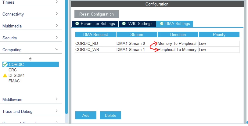

RIG
Sep 4, 2021 10:50 AM UTC
Please refer to the attached image.
I think the transfer directions of CORDIC_RD and CORDIC_WR are opposite.
See CORDIC_Sin_DMA in Example.
FMAC DMA settings are set in reverse as well.

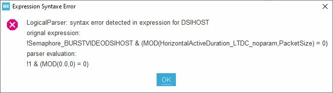

Sep 13, 2021 4:27 PM UTC
I get this error when I start my .ioc project STM32F469ZIT after update to STM32CubeIDE v1.7.0.
0693W00000Dn1lmQAB.jpgNext bug on CubeMX v6.3.0 I found when generated code for function SystemClock_Config(void) had missing RCC_PeriphCLKInitTypeDef PeriphClkInitStruct = {0}; and stuck. Take a look on this, BR.
