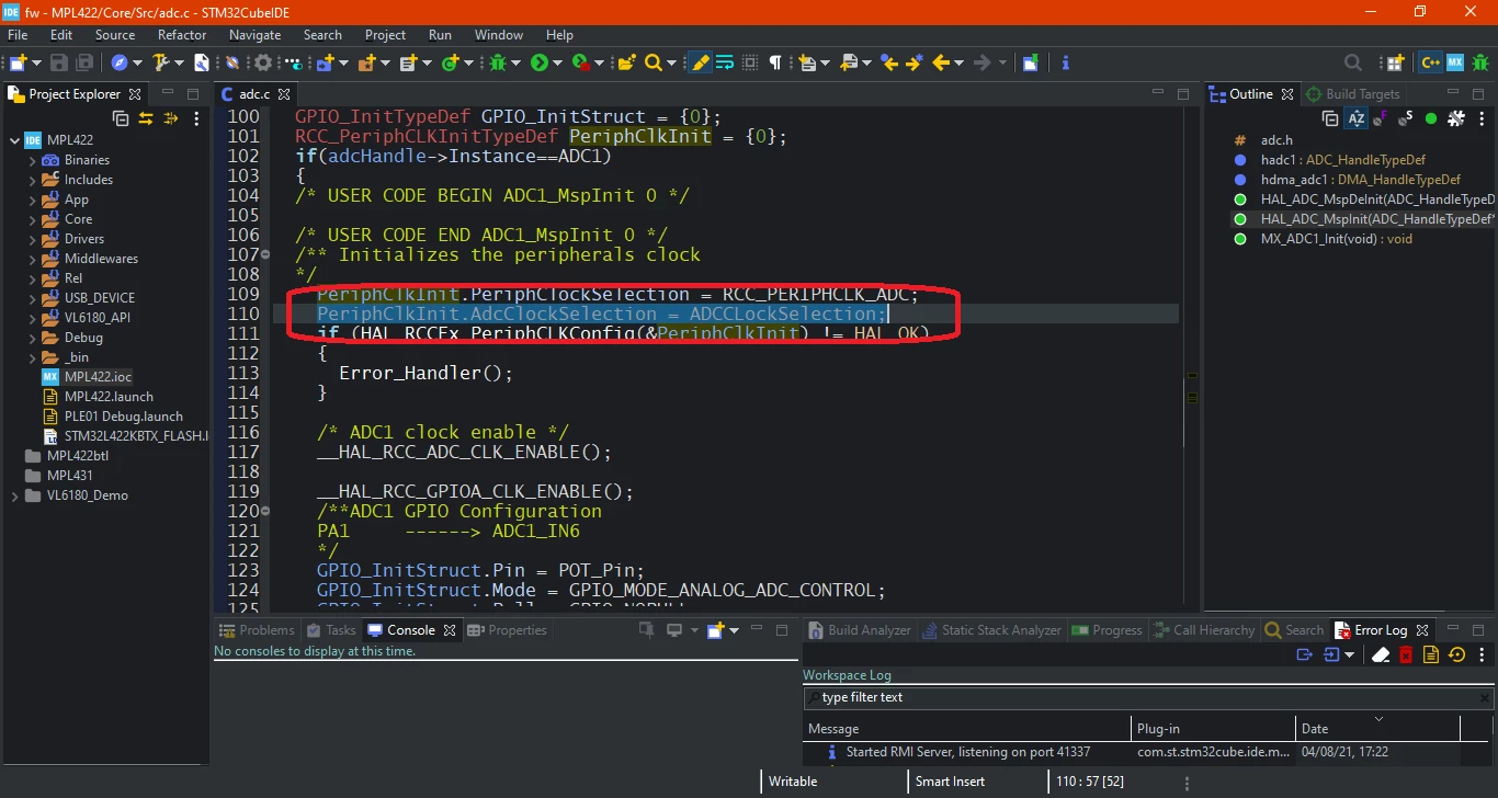

STM32CubeMX 6.3.0. Bug: ADC.C file copying error for STM32L4 Microcontroller

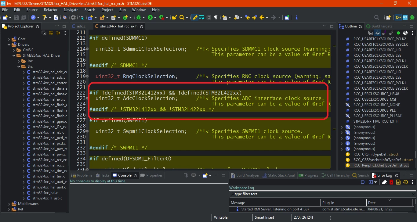

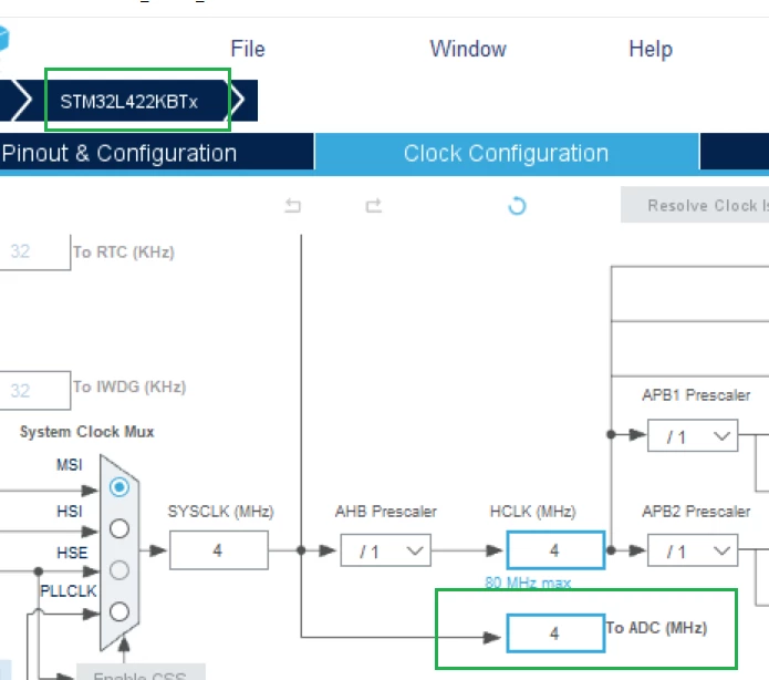

I just updated STM32CubeMX from version 6.2.0 to 6.3.0 which configured the adc.c file by inserting the line of code highlighted in the figure. The compiler gives an error recognizing that the 'ADCClockSelection' parameter does not exist. How can this error be corrected?
